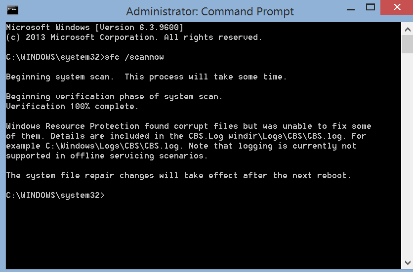

Windows update has stopped installing updates, of course - then ran sfc /scannow and found corruption.
I used DISM command to repair:
DISM /Online /Cleanup-Image /RestoreHealth
DISM reported that corruption has been fixed.
Then ran sfc /scannow multiple times and still have corruption.
Windows 8.1 on a Surface Pro. It boots properly and runs normally, I just can't do certain windows updates (the critical ones, of course).
Any thoughts?
Thank you -

Thank you for the help. I successfully uninstalled KB3035583 and tried to uninstall KB3068708 in the Control Panel and received the following error: "An Error Has Occurred. Not All of the Updates Have Been Successfully Uninstalled."
I then used the sfcfix.exe tool that was mentioned to fix KB3068708 that was listed in another thread on this site. Rebooted and tried sfc /scannow and still have the corruption message.
I wonder if I should try to manually remove KB3068708? Any other thoughts?
Thank you!

These two don't appear in the CBS.log:
Cannot repair member file [l:24{12}]"utc.app.json"
Cannot repair member file [l:66{33}]"telemetry.ASM-WindowsDefault.json"
But I have LOTS of unrepairable member files... lots.

I am trying sfc /scannow a few times. I am on my third try/reboot and still get errors. I wonder if I should try to hide
KB3035583 and KB3068708 and try to load the remaining updates and see if that works?
DISM gives me a clear bill of health - this is unreal!
Thanks for any other suggestions you might have.
Try uninstalling kb3022345. That is the one that was causing mine to error. MS has released at least three updates that have jacked up sfc /scannow. It is a false error but makes it so one can't use the tool until MS decides to fix it, unless the offending update(s) gets uninstalled.
kb3022345 wasn't installed (but I checked - thank you for that) and trying resetting windows 8.1 update components. No dice... DISM still clears, but sfc doesn't work and updates are now backing up. Current updates that can't load just came in the last few days. Includes a cumulative security update.
Am i destined to do a Refresh? It seems ridiculous that all the rest of the diagnostic tools show good (except for sfc /scannow) and it runs fine, except for not allowing updates to run.
Maybe that's good that I can't update anything from Microsoft. Maybe its a blessing in disguise.....
