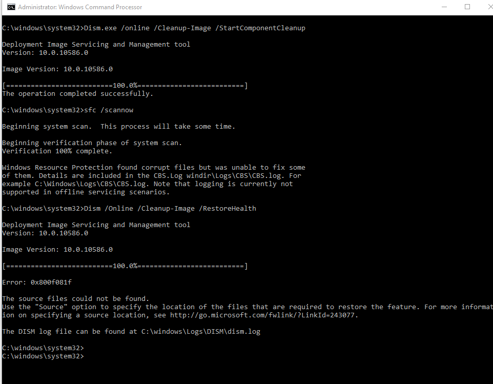

Solved DISM Source files could not befound when trying to restore

Brink should add this one to his DISM tutorial: Dism.exe /online /Cleanup-Image /StartComponentCleanup
I performed the two recommended operations above. The first competed successfully, but the second did not. The message, " The restore operation failed. Either the repair source was not found or the component store cannot be repaired" Error: 0x800f081f, DISM failed. No operation was performed." Any suggestions?
