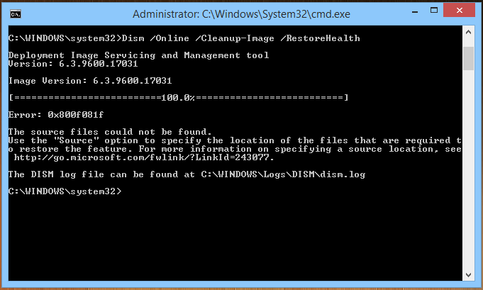

I am trying to repair corrupt files with DISM by going to Dism /Online /Cleanup-Image /RestoreHealth and it gives me the error below. How can I fix it?
Microsoft Windows [Version 6.3.9600]
(c) 2013 Microsoft Corporation. All rights reserved.
C:\WINDOWS\system32>Dism /Online /Cleanup-Image /RestoreHealth
Deployment Image Servicing and Management tool
Version: 6.3.9600.17031
Image Version: 6.3.9600.17031
[==========================100.0%==========================]
Error: 0x800f081f
The source files could not be found.
Use the "Source" option to specify the location of the files that are required t
o restore the feature. For more information on specifying a source location, see
Configure a Windows Repair Source.
The DISM log file can be found at C:\WINDOWS\Logs\DISM\dism.log

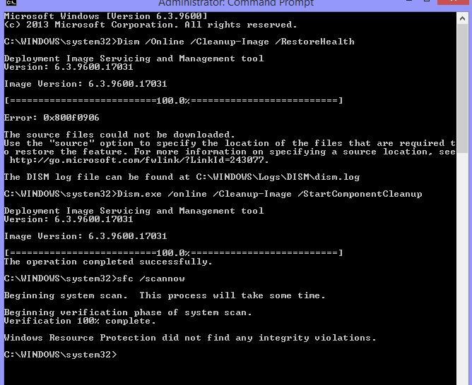

I've started having similar problems. Honestly believe it is due to the screwed up updates MS has been releasing lately.
Trying your suggestion David.
I performed the two recommended operations above. The first competed successfully, but the second did not. The message, " The restore operation failed. Either the repair source was not found or the component store cannot be repaired" Error: 0x800f081f, DISM failed. No operation was performed." Any suggestions?
I had the same problem a week or so back. Running the operations in the order recommended again the next day for some reason worked.

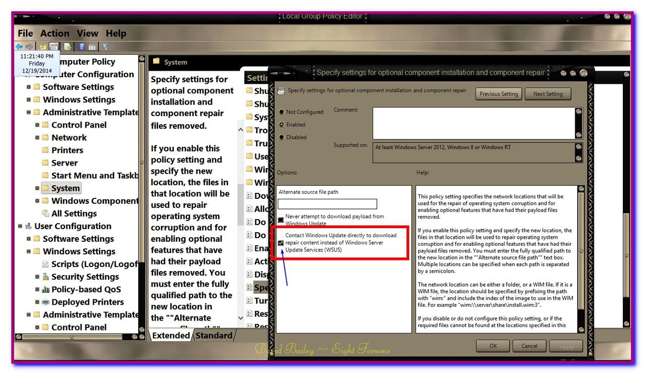

However, the fix would not work for me. I typed in the four lines in order, and still received the same error, that the source files could not be found. I then tried to open the group editor policy, to enable the "Contact windows update directly". At first it would not find gpedit.msc, so I downloaded a file for those who were missing it. I installed it, opened it, but it does not have the "Specify settings for optional component installation and component repair"setting under Computer Configuration / Administrative Templates / System ... it's nowhere to be found. I am now stuck.
