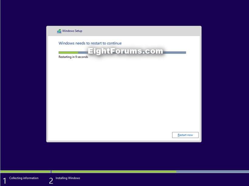

2. When installation is ready to do it's first restart, wait or click/tap on Restart now, and boot from the Windows 8/8.1 installation DVD/USB again. (see screenshot below)

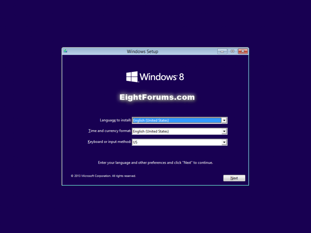

3. When you see Windows Setup after booting from your installation DVD/USB again, press the Shift + F10 keys to open a command prompt at boot. (see screenshot below)

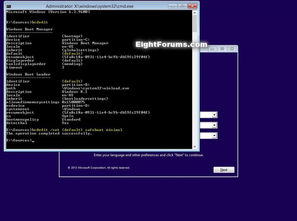

4. In the command prompt, type bcdedit, and press Enter. Under the Windows Boot Loader section, make note of the identifier value (ex: {default}) for the OS description (ex: Windows 8.1) that is the same one listed for the default (ex: {default}) under the Windows Boot Manager section. (see screenshot below)
5. In the command prompt, type the command below, and press Enter to set to boot the installation into safe mode. (see screenshot above)
Substitute identifier in the command below with the actual value or long GUID number to the right of identifer in the command used from step 4.
bcdedit /set {identifier} safeboot minimal
For example: To have this Windows 8.1 installation boot into Safe Mode using the values in the screenshot under step 4, I would type this command below and press Enter.
bcdedit /set {default} safeboot minimal

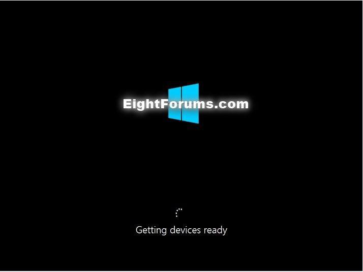

6. Restart the computer to boot into safe mode.

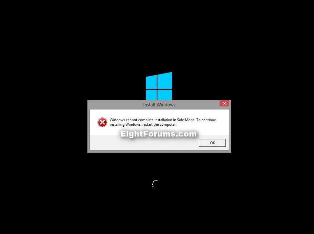

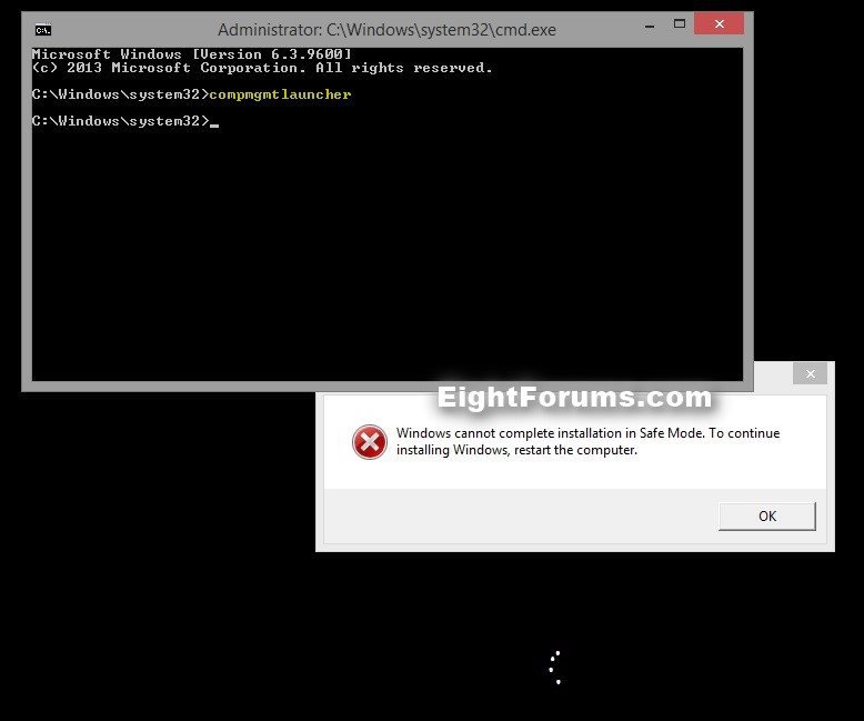

7. When the computer restarts, you will get a warning that "Windows cannot complete installation in Safe Mode...". (see screenshot below)
- DO NOT click on OK or press Enter for this warning. Just ignore it for now.
- Press the Shift + F10 keys to open a command prompt at boot.

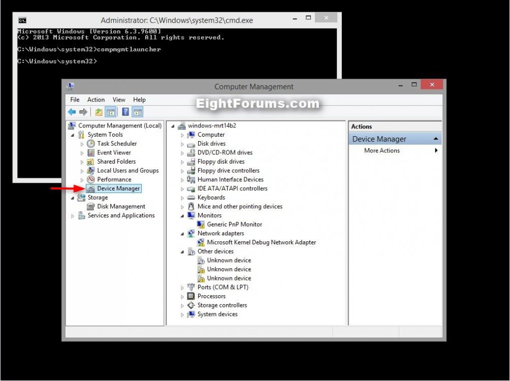

8. In the command prompt, type compmgmtlauncher, and press Enter to open Computer Management. (see screenshot below)
9. In the left pane of Computer Management, click on Device Manager. You can now disable (not uninstall) any device that you believe is causing the failure to boot. (see screenshot below)
NOTE: It may take a few seconds before Computer Management opens.
10. When finished, close Device Manager. (see screenshot above)

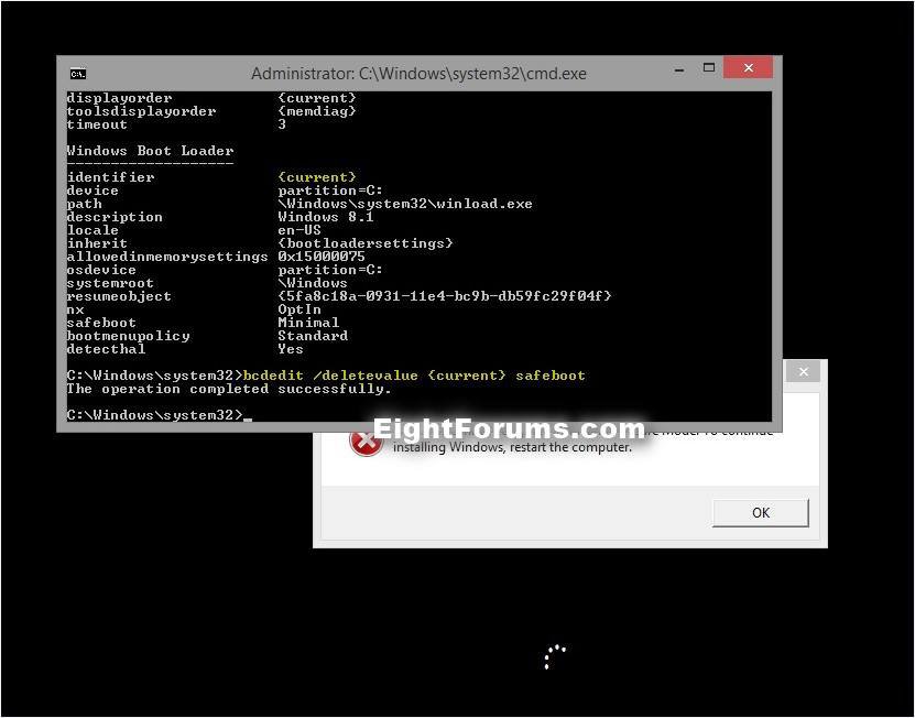

11. In the command prompt, type bcdedit, and press Enter. Under the Windows Boot Loader section, make note of the identifier value (ex: {current}) for the OS description (ex: Windows 8.1) that is the same one listed for the default (ex: {current}) under the Windows Boot Manager section. (see screenshot below)
12. In the command prompt, type the command below, and press Enter to set to boot the installation into normal mode again. This is to undo step 5 above. (see screenshot above)
bcdedit /deletevalue {identifier} safeboot
For example: To have this Windows 8.1 installation boot back into normal mode using the values in the screenshot under step 11, I would type this command below and press Enter.
bcdedit /deletevalue {current} safeboot
13. Close the command prompt, and click on OK for the warning to restart the computer and continue the installation. (see screenshots below steps 7 and 8 above)
