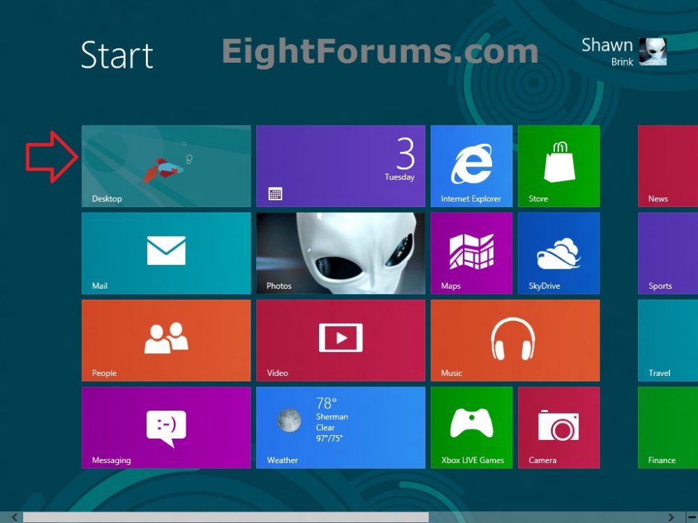

1. If you have not already, you will need to move (drag and drop) the Desktop tile to the top left corner on the Start screen like in the screenshot below.​
NOTE: By putting the Desktop tile at the top left corner of the Start screen, it will become the first tile and thus the default app that runs when you press Enter while in the Start screen.​

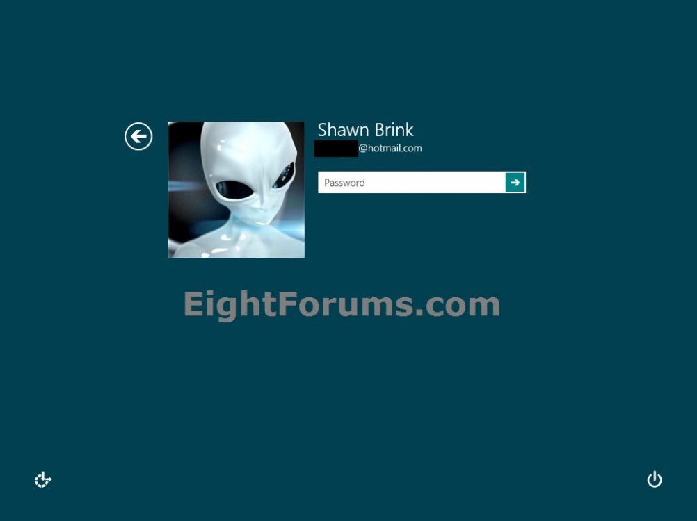

2. When you are in the log on screen next, type in your user account's password, and press and hold the Enter key. (see screenshot below)​
NOTE: Do not just press Enter or click on the "next" arrow as you normally would, or this will not work and you will boot to the default Start screen. Holding the Enter key at boot like this is workaround that allows Enter to pressed in the Start screen, and quickly runs the first tile (ex: desktop) on the Start screen without ever seeing the Start screen.​

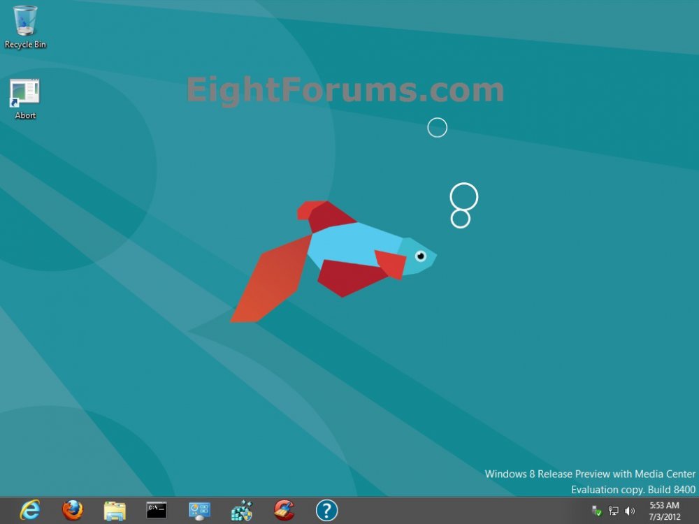

3. You can now release the Enter key as the desktop quickly appears without ever seeing the Start screen. (see screenshot below)​

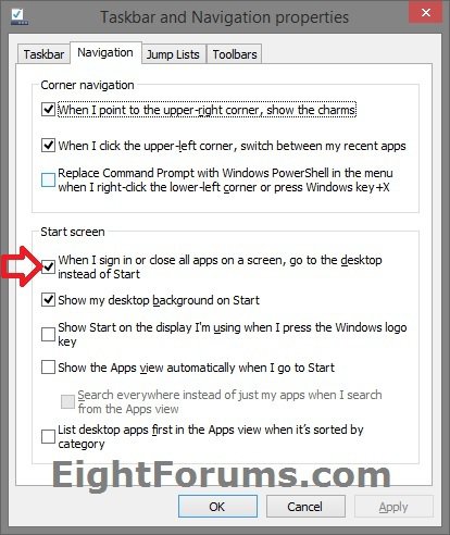

Go to Desktop or Start when you Sign in or Close Apps using "Taskbar and Navigation properties" in Windows 8.1

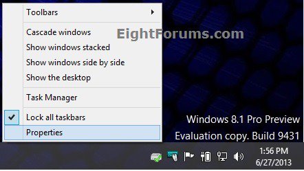

1. From your desktop, right click or press and hold on the taskbar, and click/tap on Properties. (see screenshot below)​
2. In Taskbar and Navigation properties, click/tap on the Navigation tab, and do step 3 or 4 below for what you would like to do. (see screenshot below)​
3. Go to Desktop when you Sign in or Close Apps in Windows 8.1
NOTE: This is the default setting in Windows 8.1 Update (April 8th 2014) for PCs without touchscreens.
A) Check the When I sign in or close apps on a screen, go to the desktop instead of Start box, and click/tap on OK.​
4. Go to Start when you Sign in or Close Apps in Windows 8.1
NOTE: This is the default setting in Windows 8.1, and for touchscreens in Windows 8.1 Update (April 8th 2014).​
A) Uncheck the When I sign in or close apps on a screen, go to the desktop instead of Start box, and click/tap on OK.​
