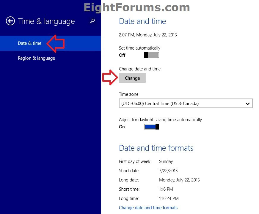

1. Open PC settings, and click/tap on Time & language on the left side. (see screenshot below)​
2. Click/tap on Date & time on the left side of Time & language. Under Date and time on the right side, move the slider to the left to turn off Set time automatically (aka: internet time synchronization). (see screenshot below)​
3. On the right side, click/tap on the Change button under Change date and time. (see screenshot below)​

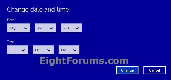

4. Change the date and time to be correct for your current time zone, and click/tap on Change. (see screenshot below)​

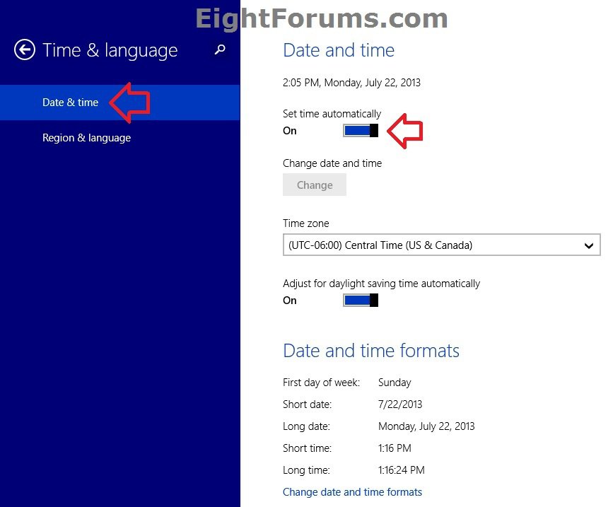

5. Under Date and time on the right side, move the slider to the right to turn back on Set time automatically. (see screenshot below step 2)​

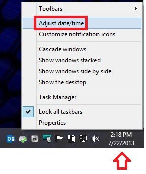

2. On your desktop, right click or press and hold on the clock on the taskbar, click/tap on Adjust Date/Time, and go to step 5 below. (see screenshot below)​

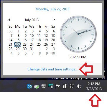

3. On your desktop, click/tap on the clock on the taskbar, click/tap on Change date and time settings, and go to step 5 below. (see screenshot below)​

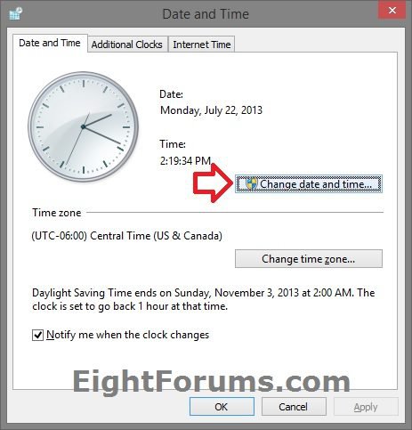

5. Click/tap on the Change date and time button. (see screenshot below)​
6. If prompted by UAC, then click/tap on Yes.​
7. To Change the Date
A) Under the left Date section, select a month and day for your current date. (see screenshot below)​
8. To Change the Time
A) Under the right Time section, select or type in your current time. (see screenshot below)​
9. Click/tap on OK. (see screenshot below)​
10. Click/tap on OK. (see screenshot below step 5)​
