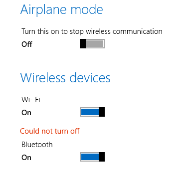

I recently recovered my samsung ultrabook(NP530-U4C). Firstly, the bluetooth option was greyed... then when I installed "Intel Centrino Bluetooth driver"... Now Bluetooth is enabled but is unable to Turn-off the Bluetooth from the Wireless section of Windows 8.
When I tried to transfer the files via bluetooth, it shows device is offline although it was just paired.

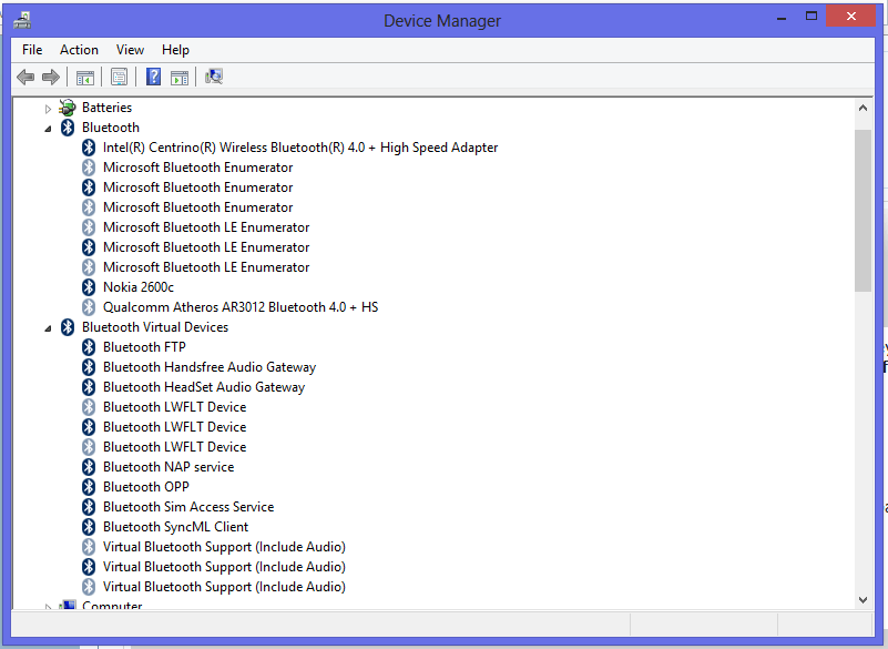

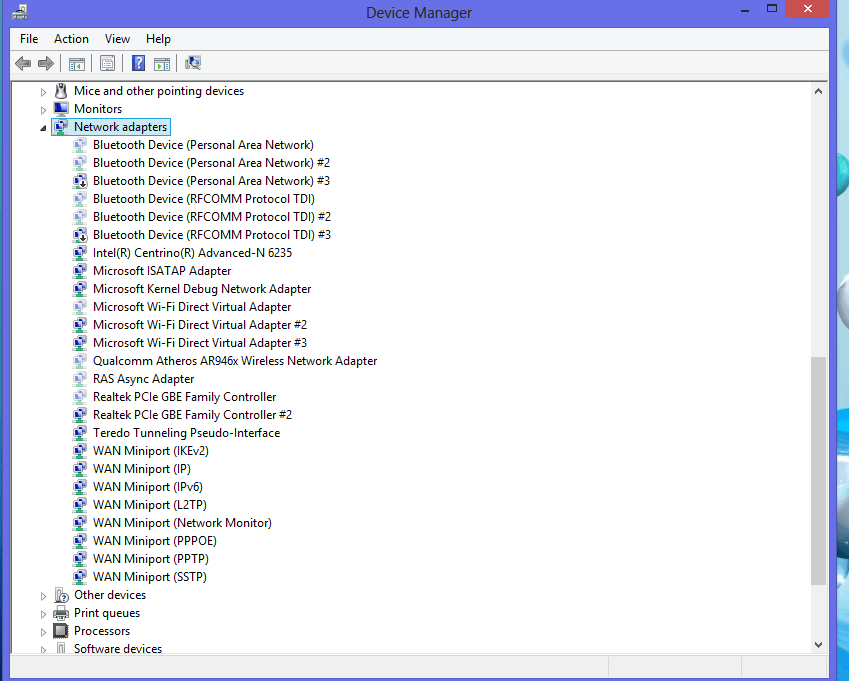

Screen shot of Device Manager(with Hidden Devices)

Thanks for your time and Sorry for the trouble! I have Intel Bluetooth and by default Qualcomm bluetooth suite was installed. When I checked Control Panel found this and after uninstalling this, Bluetooth is working fine. Although with this I installed all the windows updates and optional updates.
