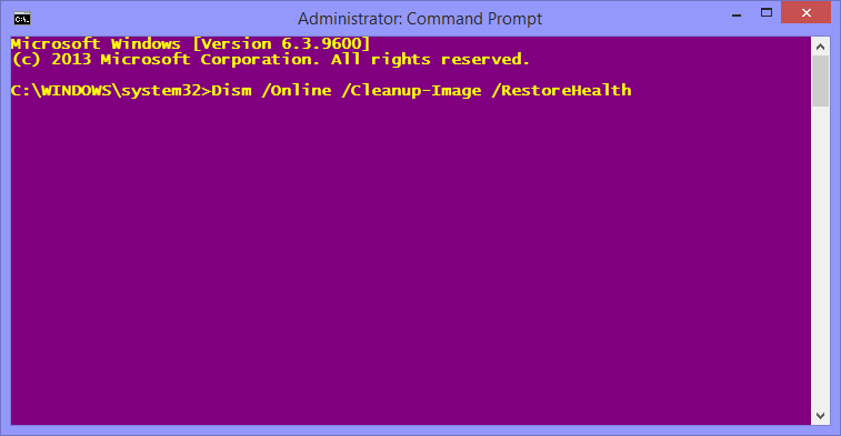

Run:
in administrator command prompt & reboot.
Then run sfc /scannow
Hi
I ran Dism /Online /Cleanup-Image /RestoreHealth,
it completed successfully then I ran sfc /scannow but got the same result,
corrupt files not fixed.
Cheers
Daniel

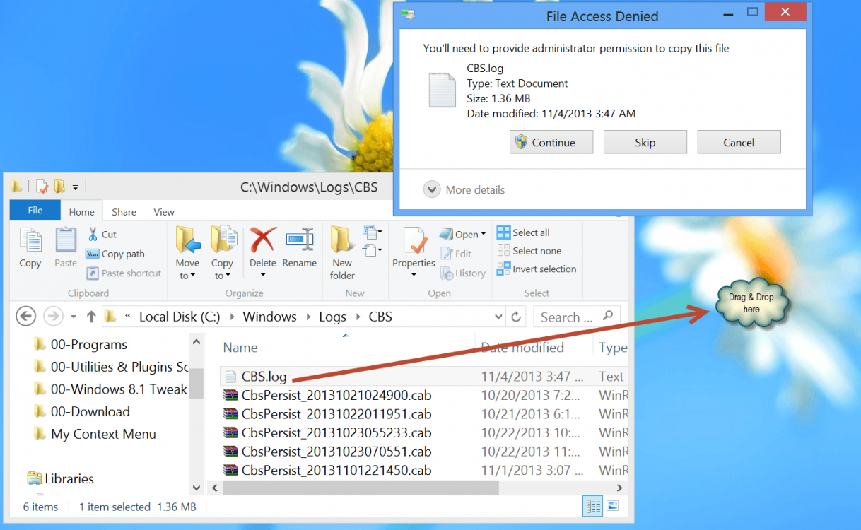

In order to view CBS.log, you will need to copy the file to your desktop.

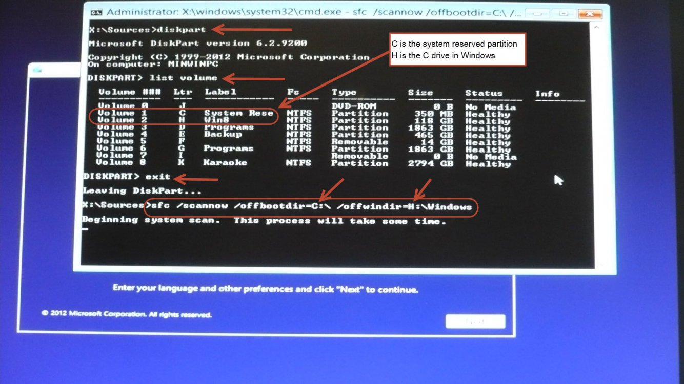

Do you have Windows 8 installation disk ? if so, try to run sfc offline.
http://www.eightforums.com/tutorials/3047-sfc-scannow-command-run-windows-8-a.html
  1. Boot your PC from the installation disk
  2. On the next screen, hold down SHIFT key and press F10, a command prompt should be displayed.
  3. Type: diskpart <ENTER> then type list volume <ENTER> and take a note of the drive letter of your System Reserved & Windows OS. Type: Exit
  4. Type: sfc /scannow /offbootdir=c:\ /offwindir=d:\windows where c: is the system reserved d: is your Windows OS drive

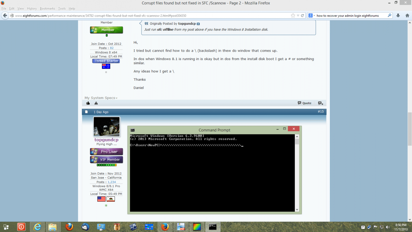

Hi,

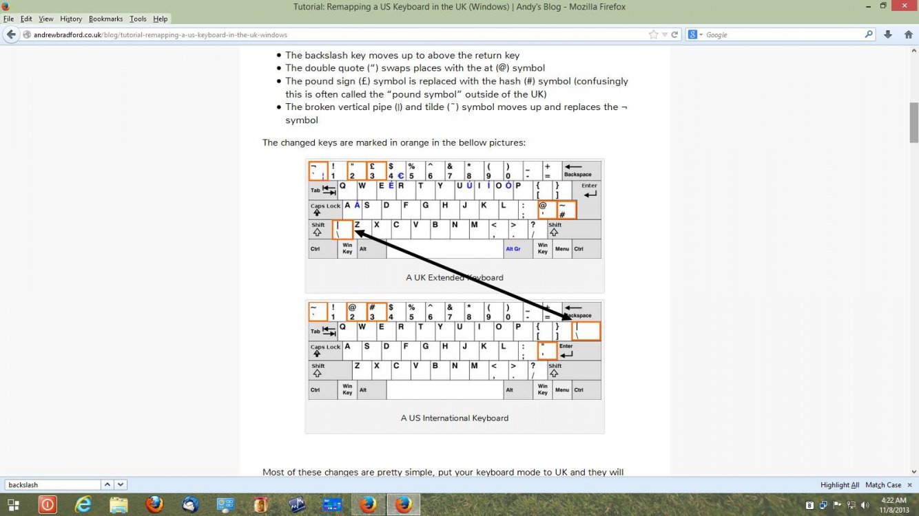

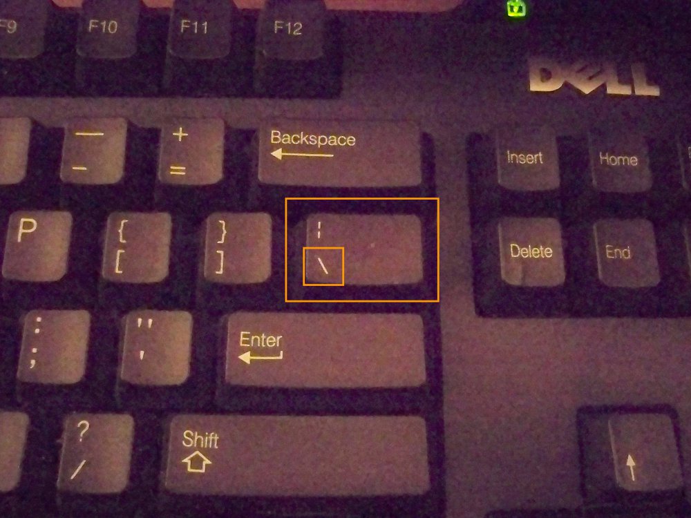

I tried but cannot find how to do a \ (backslash) in thew do window that comes up.
In dos when W8.1 is running in is okay but in dos from the install disk boot I get a # or something similar.
Any ideas how I get a \

Hi
I just thought someone who had experienced this problem may be able to help me.
I have tried every key with and without shift and none work.
Cheers
Daniel

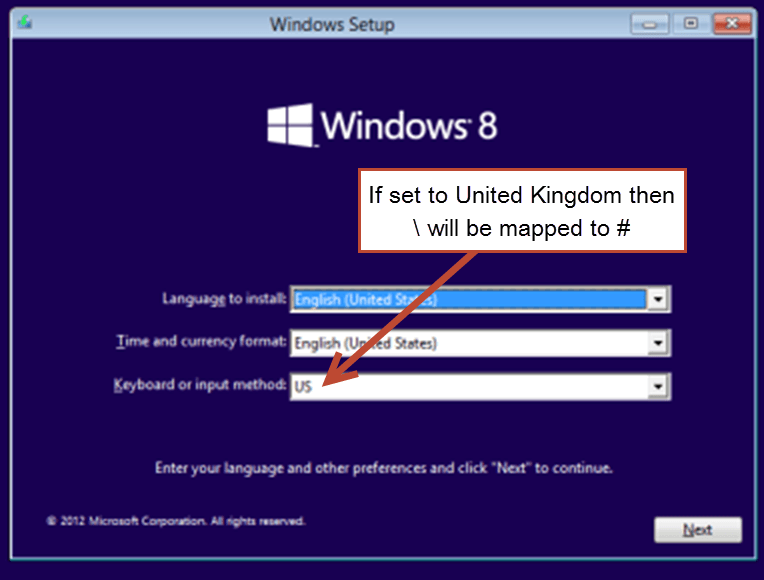

Hi Daniel,
After further study, I was able to simulate what you experienced.
On the first screen, I changed the "Keyboard or Input Method" to United Kingdom then click
Next->Repair Your Computer->Trouble Shooting->Advanced->Command Prompt
and sure enough I get the "#" instead of the "\" symbol.
You might want to double check and set it to US
Please look at the screen shot
Good luck !!!
