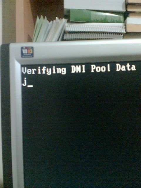

Thanks but that didn't solve my issue. My pc won't boot and stuck at this k1thq9.jpg
The pc locks at this stage and I have to reset it and revert back to ide mode.
I see that the board includes a Jmicron IDE controller. Do you have anything attached to it? If not, I suggest turning it off in the BIOS settings.
(This is sort of a random try, but as your motherboard is based on an Intel P43 chipset, I'd expect switching to AHCI to proceed normally.)
If all else fails, re-installing Windows with the SATA controller set to AHCI will fix it, but I understand your reluctance to go that route.
