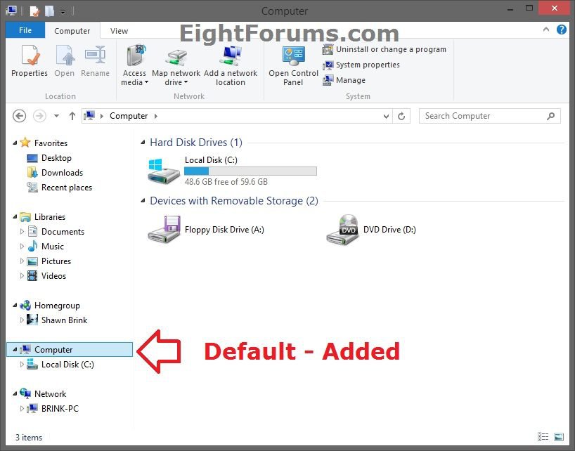

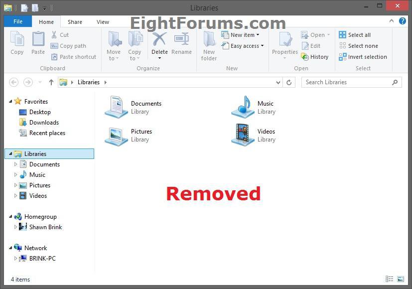

EXAMPLE: "Computer" in Navigation Pane of Windows 8
NOTE:
This is the Computer group added (default) (left screenshot below) and removed (right screenshot below) from the Navigation Pane.

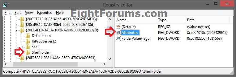

3. In regedit, navigate to the location below, then do step 4 or 5 below for what you would like to do. (see screenshot below)
HKEY_CLASSES_ROOT\CLSID\{20D04FE0-3AEA-1069-A2D8-08002B30309D}\ShellFolder

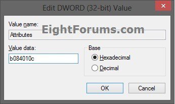

C) In the right pane of ShellFolder, double click/tap on Attributes (if there) to modify it, type in b084010c, click/tap on OK, and go to step 4D below. (see screenshot below)​

A) If you have not already, then in the left pane of regedit, take ownership of and set permissions to "Allow" the Administrators group "Full control" of the ShellFolder registry key. (see screenshot below step 3 or 6A)​
B) In the right pane of ShellFolder, right click or press and hold on a empty space and click/tap on New and DWORD (32-bit) Value. Type Attributes and press Enter. (see screenshot below step 3 or 6A)​

C) In the right pane of ShellFolder, double click/tap on Attributes to modify it, type in b094010c, click/tap on OK. (see screenshot below)​

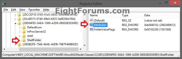

A) In regedit, navigate to the location below. (see screenshot below)​
HKEY_LOCAL_MACHINE\SOFTWARE\Wow6432Node\Classes\CLSID\{20D04FE0-3AEA-1069-A2D8-08002B30309D}\ShellFolder
B) Repeat step 4 or 5 above.​
