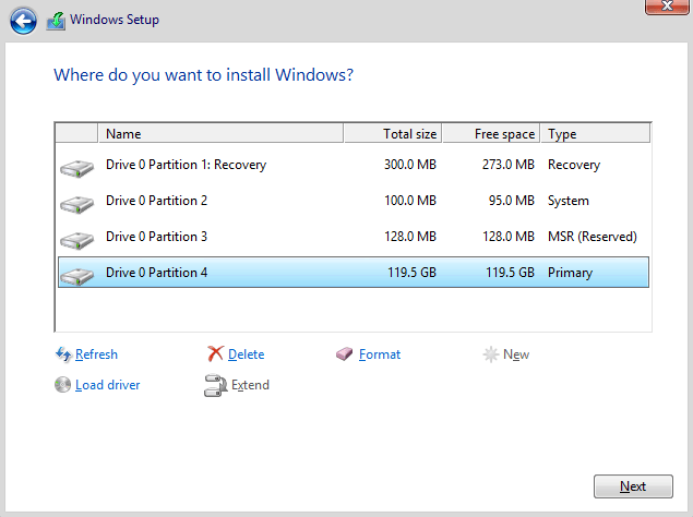

Regarding the 4 partitions referenced earlier, how does Reflect Macrium fare with regard to including all 4 partitions in an image?
When I try with EaseUs To Backup, it sees all 4 partitions, but complains "the specified file system is not supported" and needs to do a much much slower sector-by-sector backup to continue.
Should only 3 of the 4 ( the three seen by Disk Manager) be the ones included in any attempt to create an image of the SSD?
Created by Windows install:
Handling by Ease US:

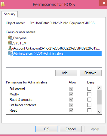

At first I did not even notice these issues... It was only after a few days when I started noticing that:
a) I could not save downloaded files off the web to my HDD data drive - rather windwows forces me to use the boot drive (of all places) as it wants it stored in the C:\Users directory. The suggested tip by some is to turn OFF Enable Protected Mode- but it didnt help. Perhaps its an IE thing... but I dont have the issue on Win 7
b) I could not save changes to files ( even thoguh could create files and folders). This one can be quais-addressed by Taking Ownership, but that's a tremendous burden to do every time you create a new file even if the folder is owned).
Again, only happens on my Win 8 machines, No issues on my four Win 7 machines.
Yet, you dont have these issues, so I'd love to figure out why !!!!

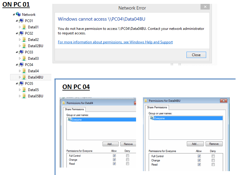

Let me give a specific example.
Context - All I am after here is for some consistency and simplicity and free reign to access my own data (nothing on the boot drive). At this point I don't even care about security. I just want access to my own files. I would love to turn all the features off that are allegedly there for my own good - they are not - all they are doing is frustrating me to no end, and giving me stress beyond description. And yet I did everything clean, fresh and by the book. Unreal number of hours wasted and I am completely exhausted. I am hopeful there is a simple fix that I have over-looked to date.
Problem - Ok see pic below.
From my main pc, PC01(Win 8.1) , I can see all my other PC's. When navigate to PC04 (Win 7) , I see both of the shared HDD's on that machine. I can navigate through Data04, but I am denied access to Data04BU. Yet both drives are shared and both have permissios set to everyone. WHY CAN I SEE ONE DRIVE BUT NOT THE OTHER.
I don't have this problem with say PC05 (Win7). Its set up the exact same way.
I dont use Homegroup at all (and don't need to, as access to PC05 is fine). All pc's are on the same workgroup.
So why cant PC01 behave the same for PC04 as it does for PC05?
On PC01 I am signed in as Dad (administrator) There is a Dad and Mom account on PC01
On PC04 I am signed in as Mom (administrator) . There is no Dad account on PC04
On PC05 I am signed in as Mom (administrator) There is no Dad account on PC05
(Now, get this,..when I sign in as Mom on PC01, the trouble accessing PC4 goes away. But that's really not the answer, as even when I am signed in as Dad, I can see all of PC05 without issue - so why cant I see all of PC04 without issue?
No problem navigating the Data04BU drive when on PC04.

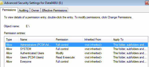

I found the missing link I was looking for.
Its not just the Sharing tab that matters ; its the Security tab.
On DataBU04, EVERYONE had full rights under Sharing (per pic above) but did not have a line item in the Security tab (per pic below). Once added the drive was available for me to access.
I still two more issues I need to work though, but that's for later. For now, I am enjoying the moment :)

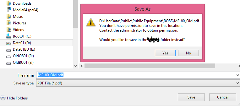

Okay, here is an example the being blocked issue.
I am on Win 8.1
I go to a web site and download a PDF file ( something I've done a thousand times on other Win 7 machines) and save it to my data drive (a data only HDD) ; it wont let me, and suggest I save it to C:\Users ... which is precisely where I do NOT want to save it.
I am signed in with an Administrator account - one that has full rights.
I tired deselecting Enable Protected mode in IE, but it didn't help
I tried re-establishing the rights by forcing child folder to inherit the full rights again, but it didn't help
All I am wanting to do here is save a PDF file to my own drive! Never ever had this issue before.
The only thing that seems to work ( though I don't know if it works 100% of the time), is to Take Ownership of every root folder in the drive , one by one. It runs through very quickly, but still, I have 187,000 files one drive so its not an instant process.
Surely, there is a setting I am missing somewhere? I do NOT have this issue on my other Win 8 machine with Win 8.1 PRO.
