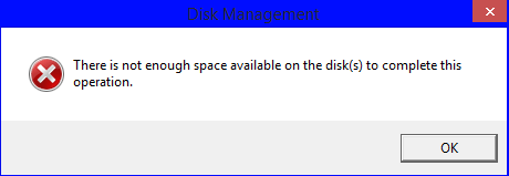

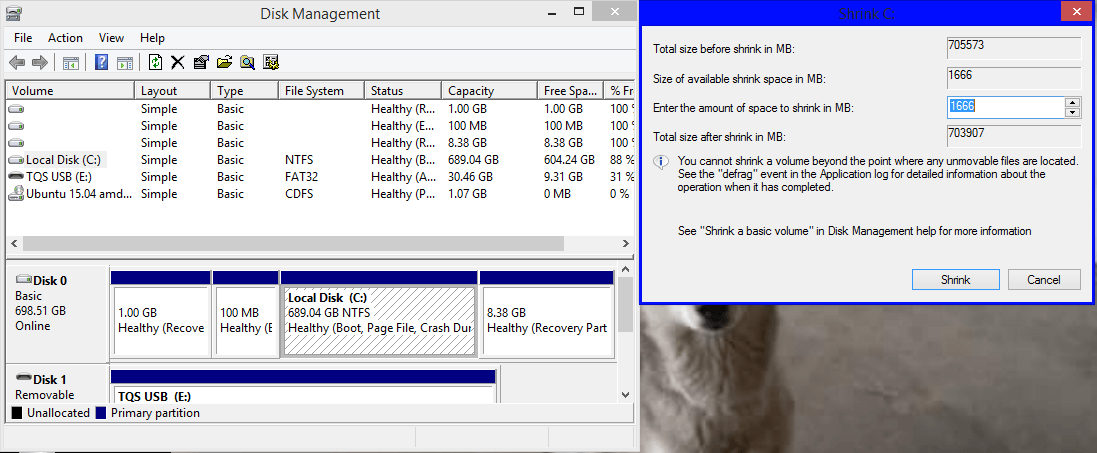

I am trying to shrink C:\ with Disk Management so I can make room for another partition, however it says the max size it can be shrunk is 1,666 MB. But even if I try to shrink it by that much I get an error (pictures attached).

Probably because the partition has to be offline to do it. I've had to use third party partition managers to do it. EaseUS has worked for me but some have had it mess up their partitions, be sure to image before using it.

The partition is fragmented. You need to run defrag first to consolidate all free spaces then try again.

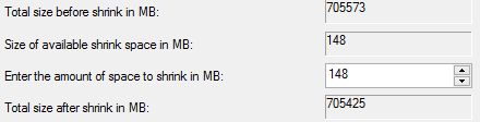

The first solution I tried was defragmenting the hard drive but that did not fix it.
If I run the program called defrag a cmd window pops up and disappears.
The result of those actions is now I can only shrink it by 148MB

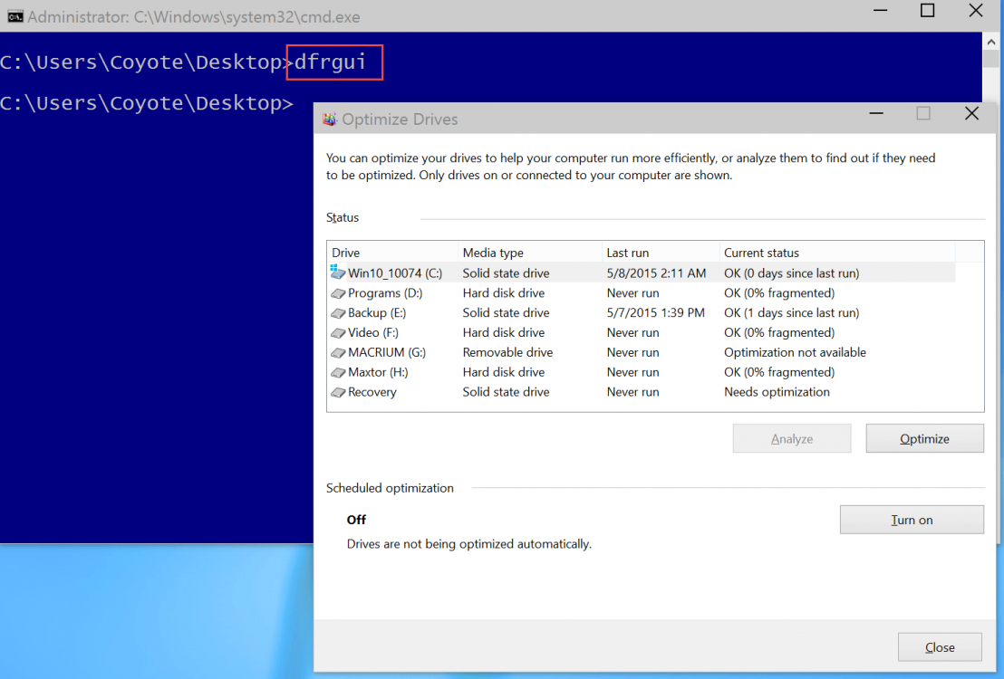

From Admin command Windows, run dfrgui. Hi lite C then Optimize

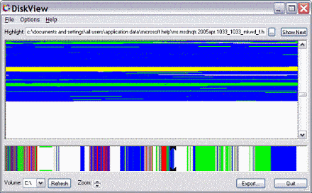

1.) Your C partition is not at the end of disk.
2.) data is spread across C partition.
If you want to see how data is spread download Disk view from Microsoft sysinternals
example of disk view:
If your disk does not look like the one above, you won't be able to shrink it.
additional defragmentations might solve this.

The size of the available shrink space can be restricted by the amount of space currently allocated to on the hard drive for the virtual memory page file, System Protection maximum storage space size, and hibernation files. The location of the files on the hard drive plays a big part here because these files are marked as unmovable, and Disk Management is unable to relocate them. As such, if these unmovable files are located in the middle of the total amount of free space on the disk, then only the amount of free space on the other side (to the right) of these files will actually be available for the new partition. This will result in you showing that you have x amount of free space, but not being able to use it for your partition. [del]The only way around this is to use a 3rd party hard drive partition management program, or setup the partition when installing Vista.[/del]

I think there may be unmovable files at the end of C:\. How do I tell and how should I deal with this if it is the case?
I remember years ago I saw a program that (I think) was built into XP, that would linearly break down the drive and color code it. I remember yellow was unmovable files. Does anyone know what I am talking about? Is it still around in Windows 8?
I remember that, the thing you're talking about is a disk defragmenter known from XP era and earlier.
defragmenters from new Windows versions do not show this data, but you can see it by using disk view ( link from my previous post )
As told by others your best bet is to make a backup and test 3rd party tools.
example: MyDefrag v4.3.1
