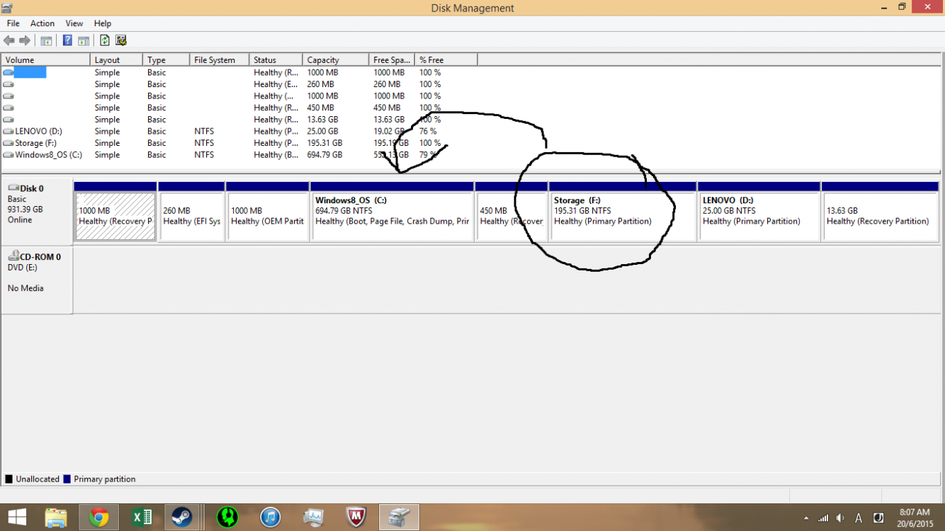

I got a problem as I cant merge back my partition after I upgraded my system to windows 8.1. I create a partition after I bought this laptop to put my personal stuff but I didn't really use it. After awhile I updated my system to windows 8.1 and now I can't merge back my partition anymore. Is there any solution to fix this??

  1. If there's any data in F: you wish to save then move/copy to C: or another place such as external HD.
  2. Open Disk Management, right click on F: ->delete Volume then you'll have a 195.13 GB unallocated space.

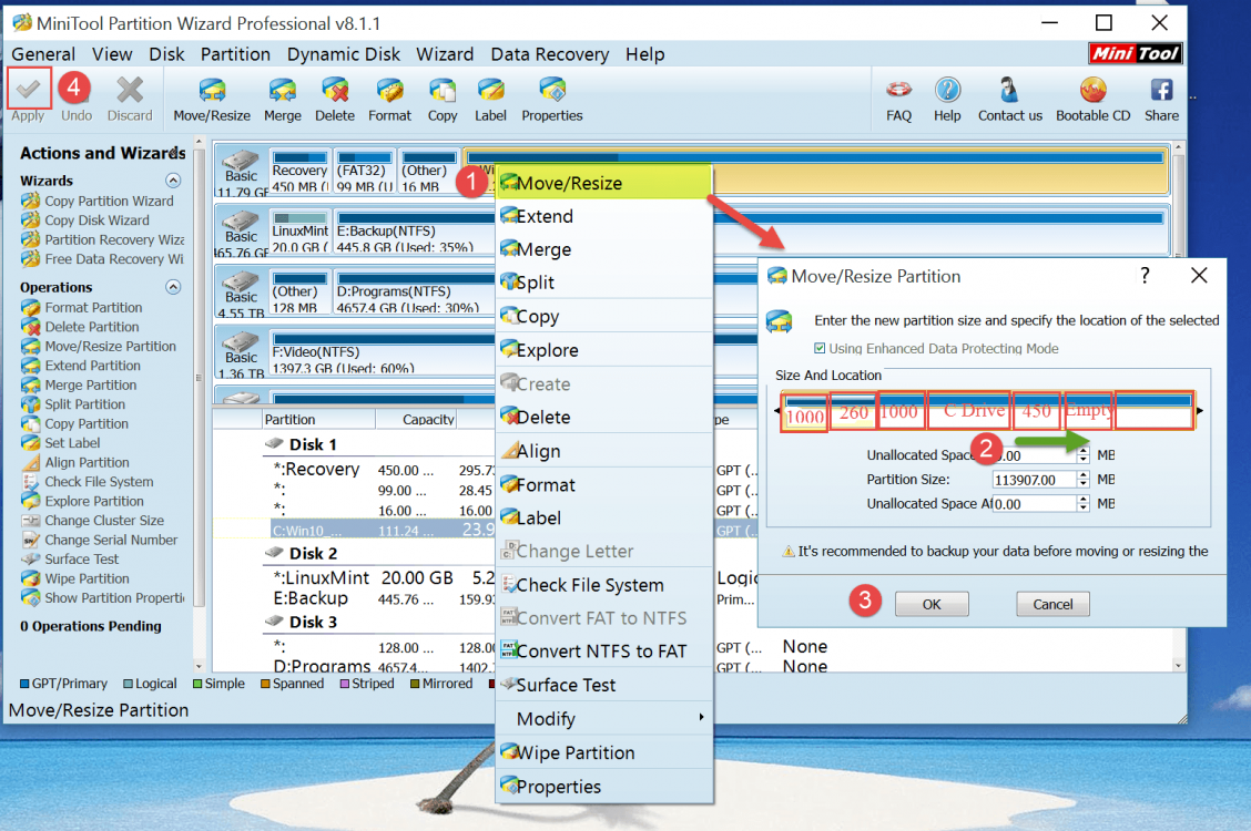

  3. Reboot your PC with the CD/USB created above. Right click on the 450MB recovery partition and select Move/Resize. A window will pop up, click and drag the partition to move toward D: drive. Click OK then click Apply from the top left to commit the change.

  5. Open Disk Management and right click on C: ->Extend Volume.
Hi, I am a bit confused about the 3rd and 4th step can you make it in more detail please? Sorry I am bad in computer
You are moving the 450MB partition to the right of the F: 191.31GB partition. Then you boot back into windows and use Disk Management to expand C: to include the space where F: is/was.

In step 3. After reboot the PC with the bootable CD/USB. You should see a screen similar to the one below. Move the mouse to point at the 450MB partition, right click on it then select Move/Resize, you'll get the next screen. Click and hold the 450MB partition again and drag it to the right (See green arrow). You will end up with: 1000, 260, 1000, C Drive, Empty, 450MB partition, D drive.
Click OK then click Apply (#3, #4 from screen shot):
NOTE: The screen shot with all disks listed is from my PC so it would be different from yours. I just edited the "Move/Resize Partition" screen to reflect what your disk partitions look like.
This is a very detail explanation! Thank you very much and I finally solved this!
