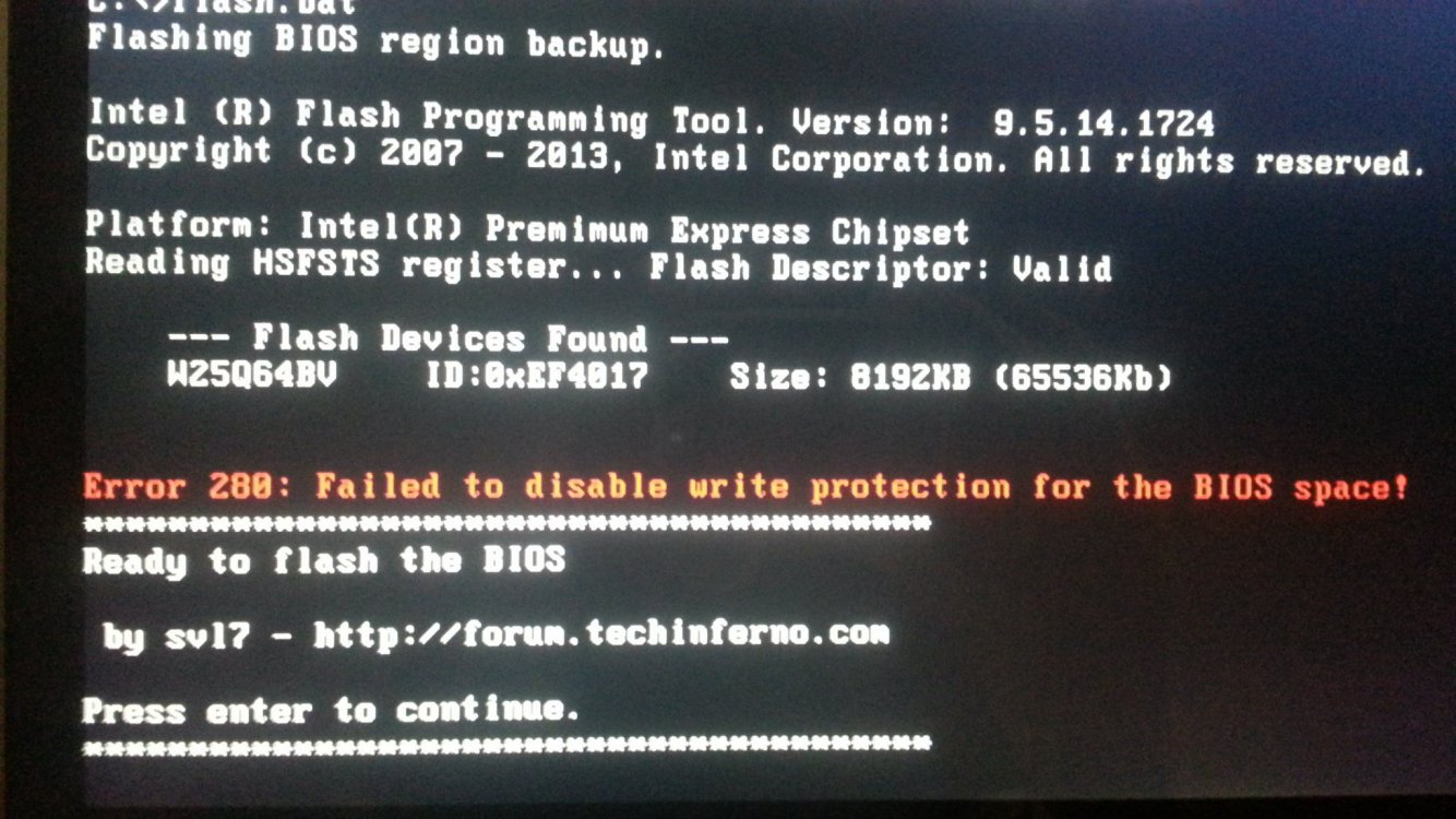

I turned off secure boot and enabled lagacy boot. But when I boot from the USB stick I get this error:
"Error 208: Failed to disable write protection for the BIOS space"
To answer your question, I'm trying to unlock the BIOS using flash.bat provided by BIOS-mods.com.
Attached is a screenshot of the error. Take a look and let me know what you think.
It sounds like the script or whatever it is, is supposed to disable the BIOS write protection and it failed. I would go to wherever you got the script and get support from the authors. As alphanumeric points out, any BIOS update can bork your system totally. There is always a risk.
