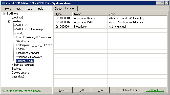

How to add Wubi loader to Windows 8 boot menu
How to add Wubi loader to Windows 8 boot menu. (Ubuntu+Wubi already installed on disk)
Run Visual BCD Editor. Right click in left pane - select "New BootSector(Linux) loader".
This will create a loader with default values for device and path.
Now locate drive where Ubuntu is installed - by default in \ubuntu directory.
Say you located \ubuntu on drive D:
Change default values for device and path in created boot sector loader to: VBCDE_Wubi.png
ApplicationDevice - D:
ApplicationPath - \ubuntu\winboot\wubildr.mbr
