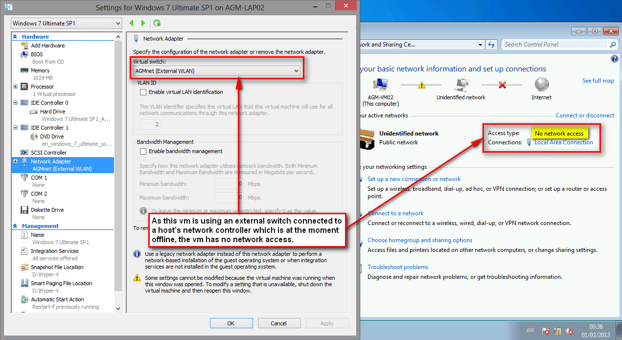

That sounds like if your virtual switch is connected to a NIC which is offline:
(Click to enlarge.)
Check this tutorial to see how to connect a host NIC to a virtual switch, screenshot in Part 2 step 3: http://www.eightforums.com/attachme...-virtual-switch-manager-virtual_switch_03.png

Can you access internet normally from your host?
Hyper-V and its virtual switches are quite straight forward: if properly set up, they will work.
Most common errors for no network connection are:
- Virtual Switch is not connected to a physical network adapter on host
- Host NIC which virtual switch is using is offline, not connected to network
- External switch accidentally set as private or internal
You could try deleting your switch and the XP vm's network adapter. Then create a new external switch, connect it to a NIC which is not already used by another switch. Now go to vm's settings and create a new legacy network adapter, connect your new switch to it.
It should work.
Kari

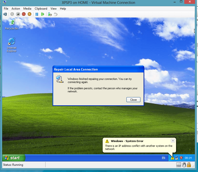

Again limited or no connectivity. Using CMD and ipconfig, I noticed that the IP address started with 94 when my ISP stsrts with 96. I changed the IP settings manually including DNS, which I use on my normal OS's. Again Limited or no etc. I rebooted but this time it showed "trying to connect" which went on for a long time so I clicked repair. A message came back that windows could not finish repairing the IP address but at the same time my internet connection showed "connected".
My sudden elation was short lived because when I treid to get to Google using Internet Explorer it came back that the page could not be displayed, so I tried Bing, MSN etc with the same result. Looking at the connection status, packets were being sent but none were being received.
I tried another repair but this time I got a warning symbol stating that "There is an IP address conflict with another system on the network" and I was back to limited or no connectivity. Curiouser and curiouser!

My "error" screen shot is: -
Hope this helps
Gramcam

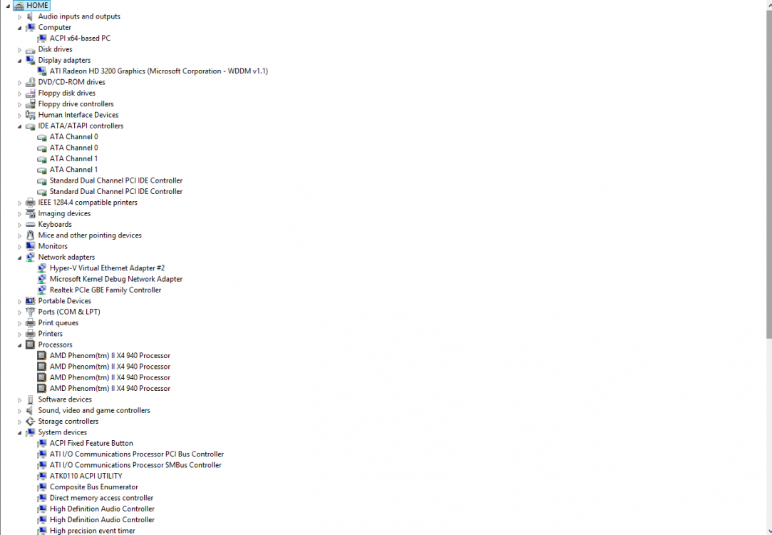

Hope this Hardware Configuration is what you want.
Gramcam
Hi Jimbo,
To recap.

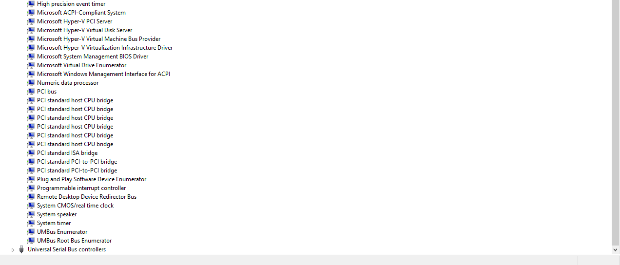

The screen shots of my hardware configuration are below. I opened up some of the devices I think you will want to see.
I have 8 GB of DDR2 800 RAM. If you need more please let me know.
I'm going to install a VMware in winXPSP3 on my XP 32 bit hard drive just to test if my Realtek NIC does work In VMware. I'll leave the Hyper-v in win 8 alone to test out Kari suggestions., unless you think there will be a conflict
Gramcam
