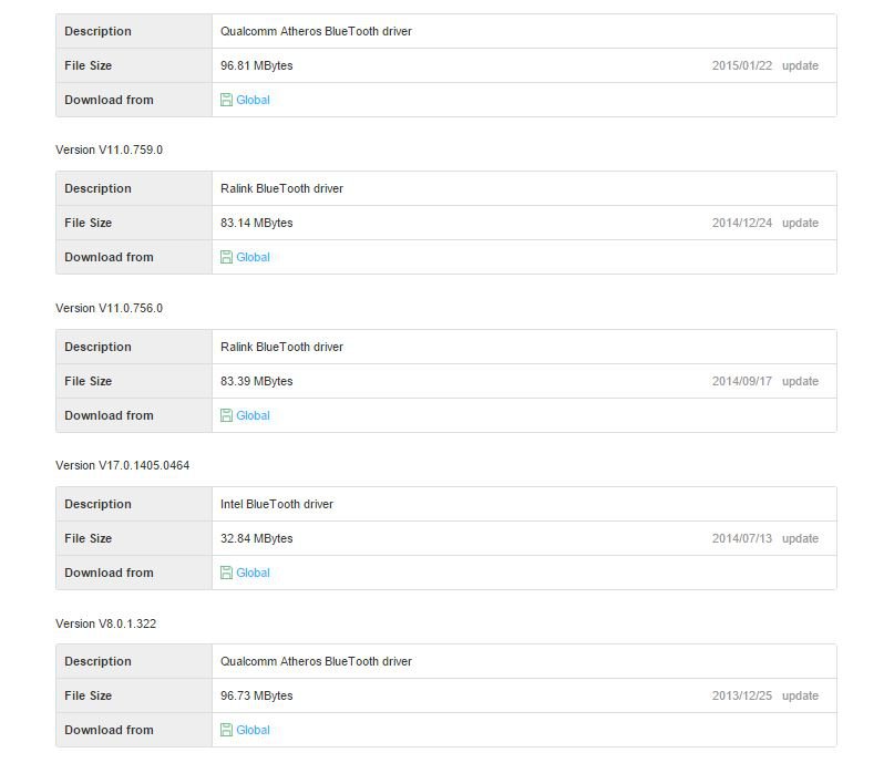

Which Bluetooth module do you have? The Asus site shows 5 different drivers:
The first one I guess?

Which ones did you install? With Bluetooth it is possible to install the wrong drivers and have it appear to be working but some features not to work properly. As an example the generic Broadcomm drivers will install on almost all machines but may or may not work properly.
If you are sure it is the Atheros Bluetooth, then download and re-install those drivers. I would uninstall everything under Bluetooth in Device Manager and reboot first.

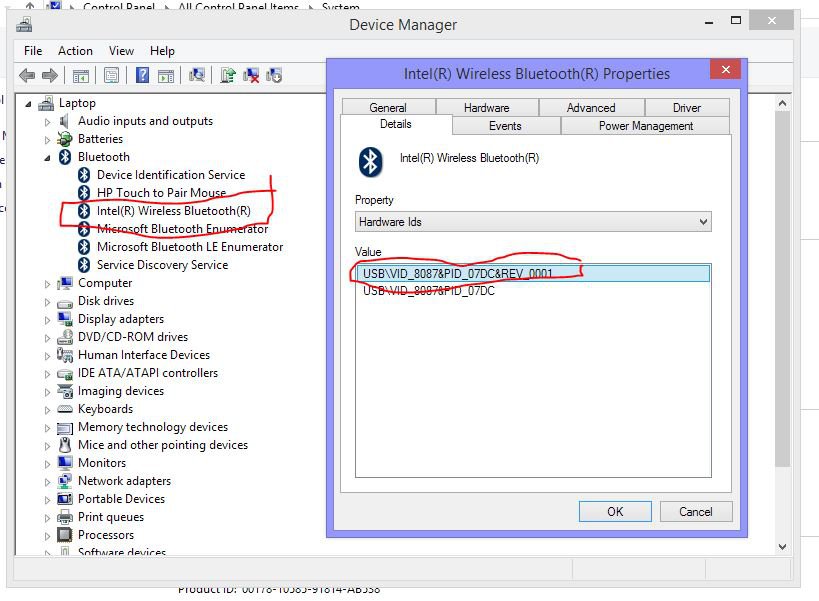

Go to Device Manager and open the properties of you Bluetooth adapter, then click on details and get the hardware ID. Copy the ID then do a paste and search in your browser. The results should show you what adapter you have.
If the Qualcomm/Atheros, then download the latest drivers from the Asus site and re-install as I said above.
USB\VID_13D3&PID_3402&REV_0001 which is Qualcomm/Atheros
