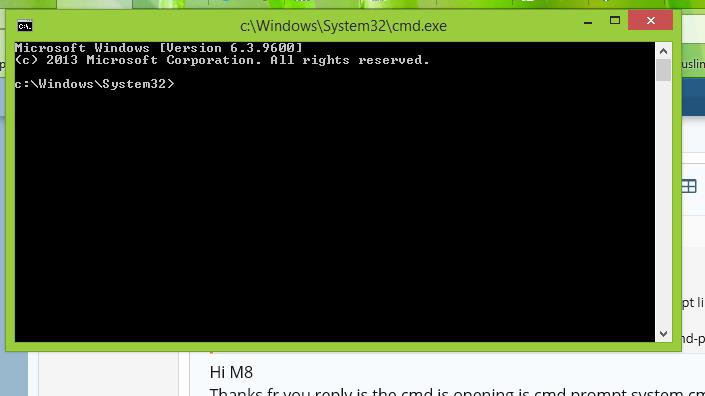

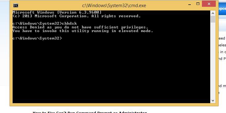

Hi M8
Thanks fr you reply is the cmd is opening is cmd prompt system cmd

Hi M8
Did you do anything like disable UAC that may be causing this?
Did you right click on the cmd.exe, and click on "Run as administrator"?

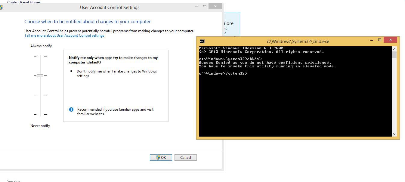

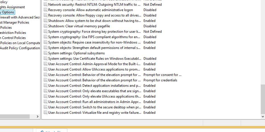

I tried enabling UAC everthing this is clear kindly guide me m8
Just to verify, did you right click on the cmd.exe, and click on "Run as administrator"?
Is UAC still set to default like below?
Tried doing it after i moved UAC and clicked on OK i was prompt Yes it is default
Odd issue. Do you see the same thing in other administrator accounts?

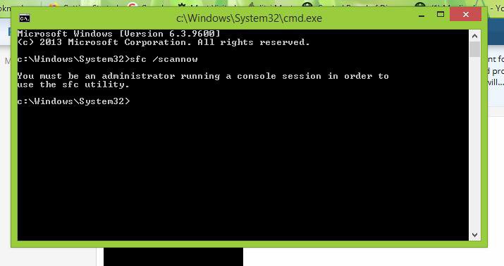

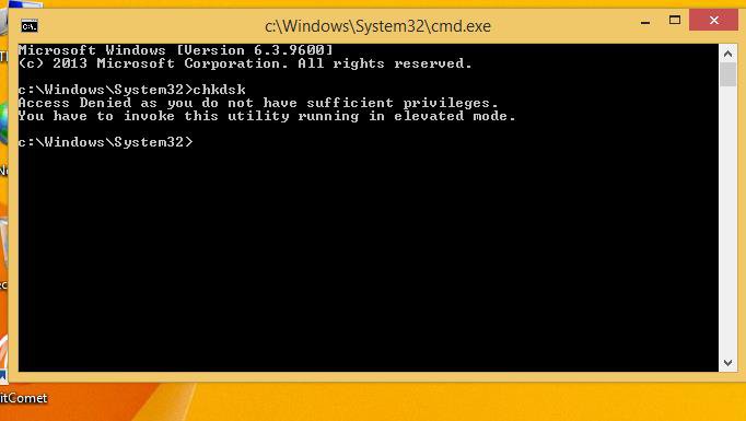

M8 have tried many steps finally getting same error cant run chkdsk and sfc scannow :(
