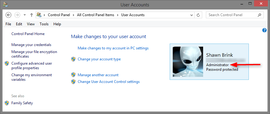

administrator user - Is an unelevated administrator account that is created by default during the installation of Windows 8 or 8.1, or is already setup for you on a OEM (ex: Dell) computer. This account can be a local account or Microsoft account. An administrator account has complete access to the computer, and can make any desired changes. To help make the computer more secure, this administrator account type will be prompted by UAC by default to give confirmation before allowed to make any changes that require elevated administrator rights. Such as those that affect the system, other users, or when running anything elevated (Run as Administrator) since running elevated will allow it to have access to the entire computer.

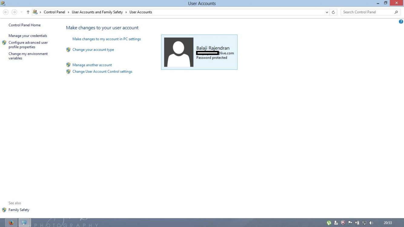

Untitled.jpgmy user account snap shot is here sir
    windows 8 single language pack
    dell insprion 15
That would be why then. You're account is not an administrator type account.
You must be signed in to an administrator account to be able to do the tutorial.
i am not able to sign with administrator account sir....That account is not shown...
what i do mistake is "netplwiz" command is run on my pc then all privileges are gone sir

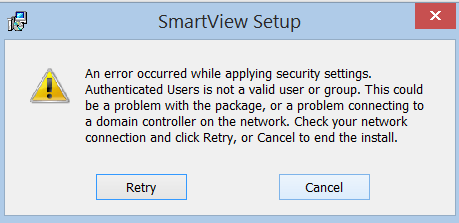

The purpose is to install the "smart view" apps froms Samsung on my PC
When trying this i get the following msg: see file attachd (hope it's in the msg..)

Birza,
Are you able to install the program while signed in to your normal administrator account (not the built-in Admin)?
Is this below where you downloaded the Samsung SmartView app for Windows 8 from?
SmartView
yes that is it exactly apps charged on Samsung site.
No i can install the program when logged as "normal administrator account
But like i told you i think i can't access the "build in administrator account"

unfortunatly i'm logged in as administrator but i get always the same message
