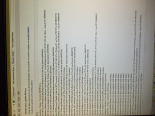

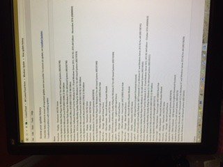

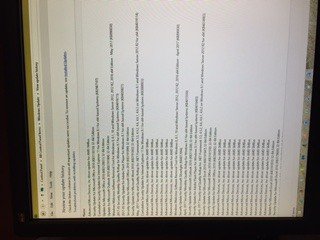

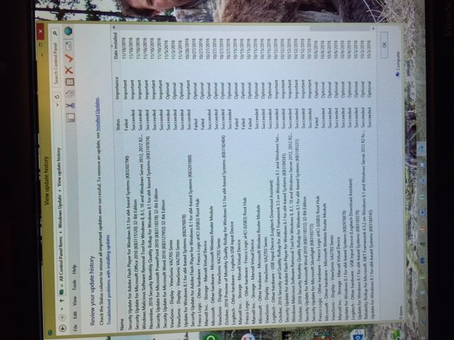

Update Windows completely, including recommended and optional onces.

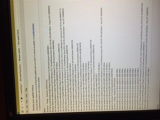

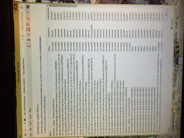

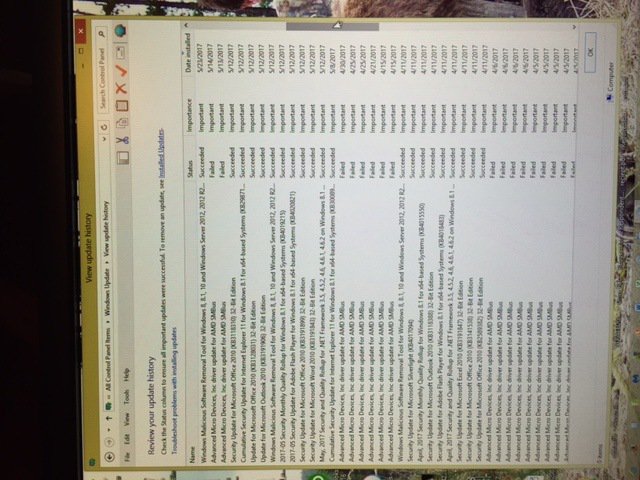

I just went & had a look at Windows Update, tab, review update history & it shows an AMD Inc driver update for AMD SMBus that has failed to install 19 times all the way back to 4/19/2017.
Could this be what you are refering to that needs updating?
The last time this driver update for SMBus failed was 5/25/2017
In 2 years, only 11 hotfixes is by far updated.
Before the time of the monthly roll-up there have been tons of updates released.
All updates before the monthly roll-up are not included in the monthly roll-up, as such you should have tons (hundreds) of updates installed.

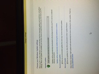

What are your Windows Update settings for recommended, important and Microsoft product updates?
Windows updates
Axe
my windows updates are shown in the images, together with all my updates
My updates are recommended & important updates are automatic, the system was built 3/15, the updates go back to 10/3/2016.....

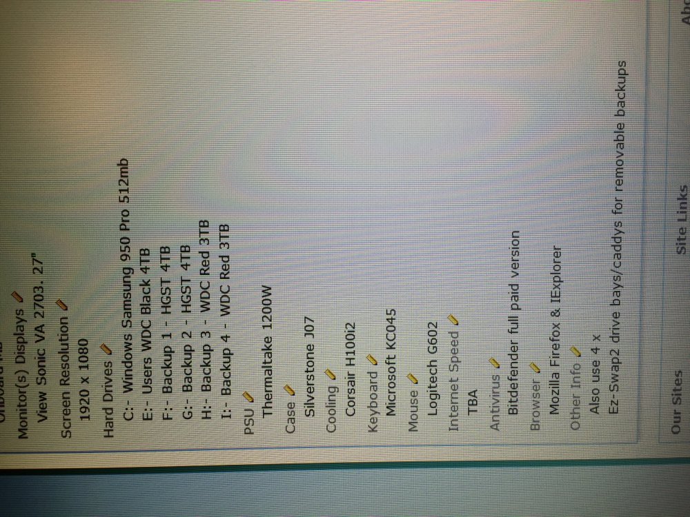

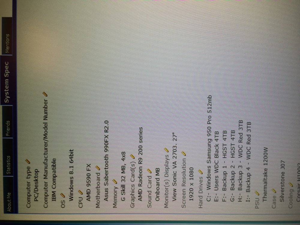

Here is the specs of the system from the 7forum:-
Computer type PC/Desktop Computer Manufacturer/Model Number IBM Compatible OS Windows 8.1 64bit CPU AMD 9590 FX Motherboard Asus Sabertooth 990FX R2.0 Memory G Skill 32 MB, 4x8 Graphics Card(s) AMD Radeon R9 200 series Sound Card Onboard MB Monitor(s) Displays View Sonic VA 2703. 27" Screen Resolution 1920 x 1080 Hard Drives C:- Windows Samsung 950 Pro 512mb
E:- Users WDC Black 4TB
F:- Backup 1 - HGST 4TB
G:- Backup 2 - HGST 4TB
H:- Backup 3 - WDC Red 3TB
I:- Backup 4 - WDC Red 3TB PSU Thermaltake 1200W Case Silverstone J07 Cooling Corsair H100i2 Keyboard Microsoft KC045 Mouse Logitech G602 Internet Speed TBA Antivirus Bitdefender full paid version Browser Mozilla Firefox & IExplorer Other Info Also use 4 x
Ez-Swap2 drive bays/caddys for removable backups

Please fill in your system specs the way I requested, I can't find your username on sevenforums.com.
The system crashed because the CPU detected an unknown hardware error on core 2 whilst executing instructions it received.
Because it is an unknown hardware error, I can't tell what send the instructions.
My username @ sevenforums is the same as here Riobonitoranch,
I uploaded the specs from sevenforums to an attachment on this reply
