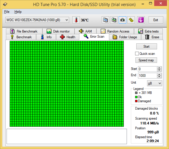

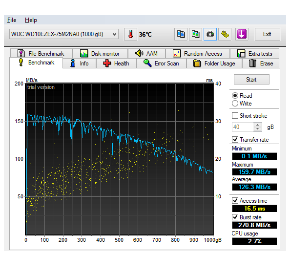

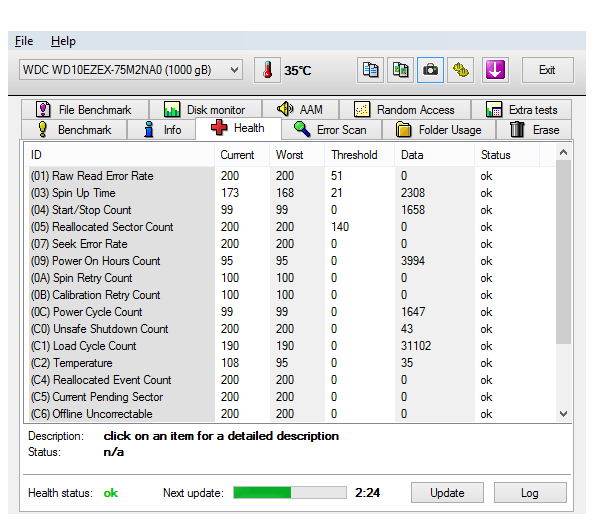

Please run HDTune first, in the order posted!
Run HDTune to
  • check the health,
  • scan for errors, no quick scan but full scan
  • run a benchmark.
It may take some time, but please take the time you need to perform it properly.
When above is done please make screenshots of the following
  • the health,
  • the error scan,
  • the benchmark incl. following
    • transfer rate,
    • access time,
    • burst rate,
    • cpu usage.

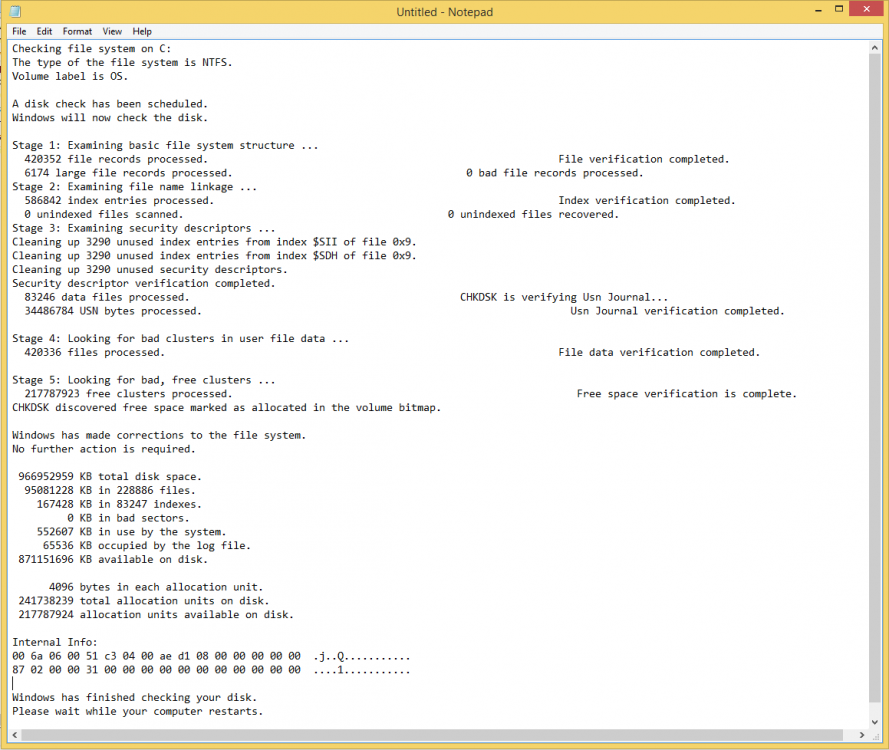

Run chkdsk
Disk Check - Windows 7 Help Forums
Use option TWO with parameter /r

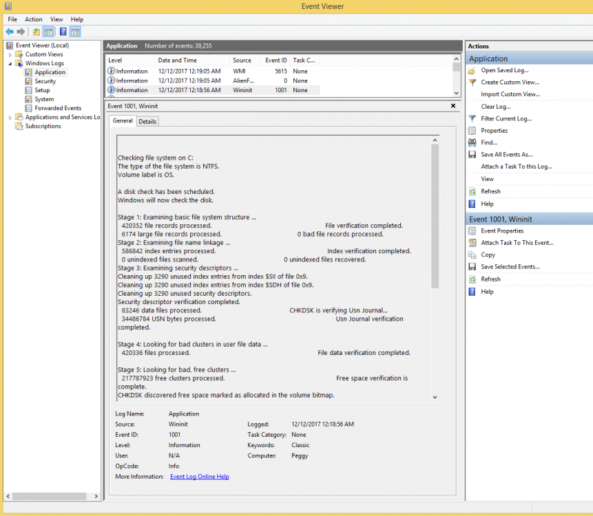

Upload the chkdsk log :ar: Check Disk (chkdsk) - Read Event Viewer Log - Windows 7 Help Forums
Please follow the chkdsk instructions accordingly.

Attached is the correcft chkdsk (I put two files in case you can't read it from event viewer). Oh, and I also got another BSOD.winnit chkdsk log event viewer.pngwinnit chkdsk log.png
