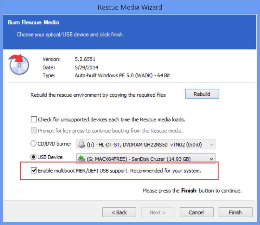

Your system spec does not tell me whether you are running 32 bit or 64 bit. UEFI is supported in 64 bit only. So if you have 64bit and your BIOS is setup for UEFI.
  1. Build the Rescue disk and in one of the screen, make sure you have checked as shown in the screen below:
  2. You don't need to change anything in the BIOS. For ASUS Laptop, the one time boot is <ESC> key so you need to keep tapping on it during the boot up.
  3. Select UEFI-USBXXX.
Thanks for all your replies chaps[chapesses],my system is 64 bit but i think the usb pendrive was faulty so as a result was not being recognised,so built another and on RESTART i kept the "esc" key depressed and sure enough up popped the one time boot screen where i was able to choose the usb drive and boot straight into the Macrium recovery environment.Only on this forum did i actually find/receive the info needed to answer my question,so once again thanks to all and keep up the good work.

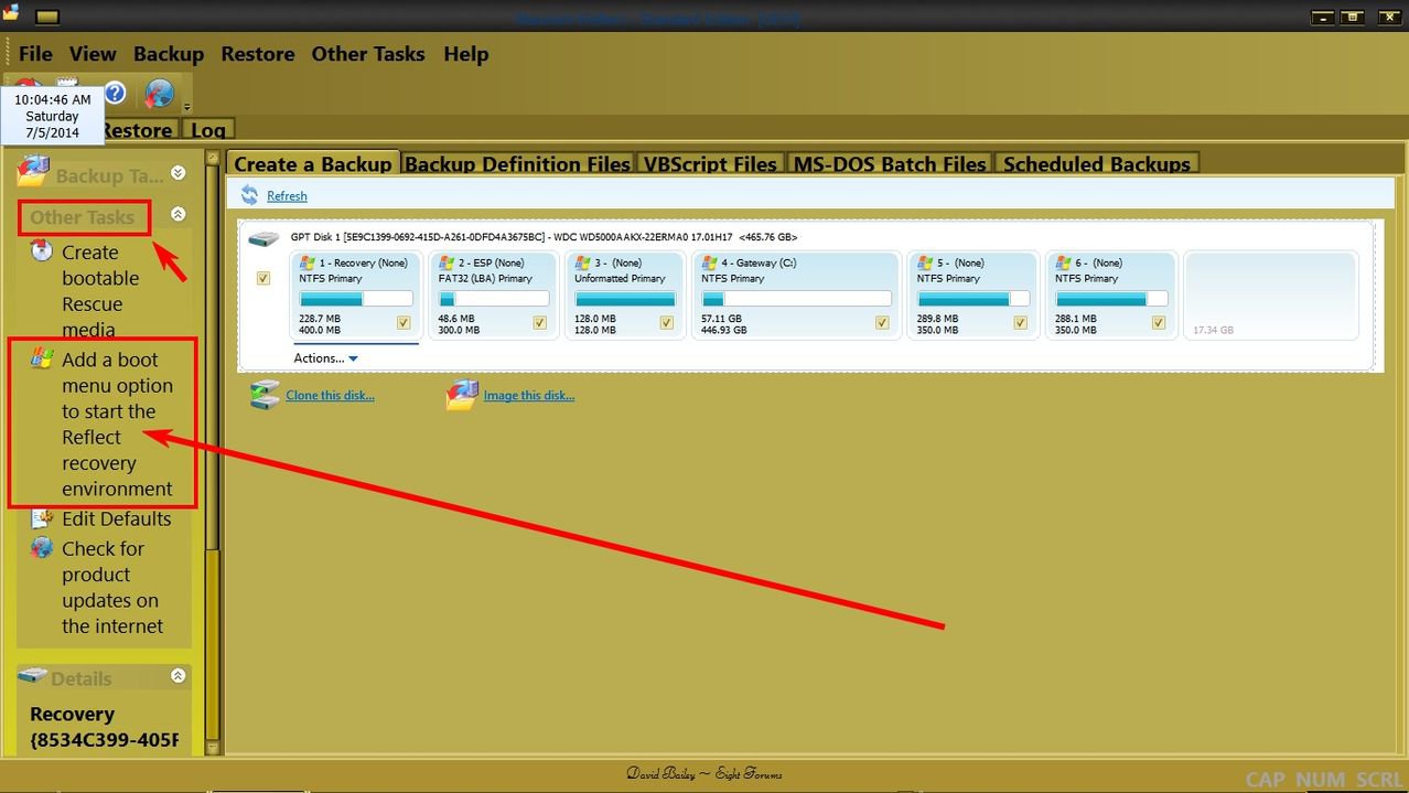

Hi everyone. I just joined specifically to share the solution to the same problem with my own Windows 8.1 ASUS laptop.
Regardless of trying many possible solutions, the Macrium Rescue Boot USB would not boot, or simply stall every single time and go no further.
I discovered this through much trial and error from searching online for literally hours.
Please see the two screenshots here, as this most definitely worked for me and should for you too.:D
(For Windows 10 you should choose Windows PE 10.0 as your rescue media option...)
1. VIP!  Procedure for using Macrium Reflect Rescue Boot Media to Restore Image.jpg
2. VIP!  Procedure for using Macrium Reflect Rescue Boot Media to Restore Image.jpg
