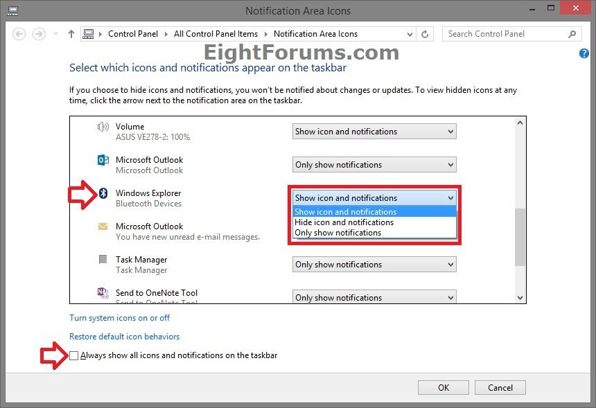

B) Double check your Notification Area Icons settings to make sure that you have Bluetooth Devices set to what you want to either hide/show, or "Always show all icons and notifications on the taskbar". (see screenshot below)

8. If you used step 2, then double check your Notification Area Icons settings to make sure that you have Bluetooth Devices set to what you want to either hide/show, or "Always show all icons and notifications on the taskbar". (see screenshot below)
