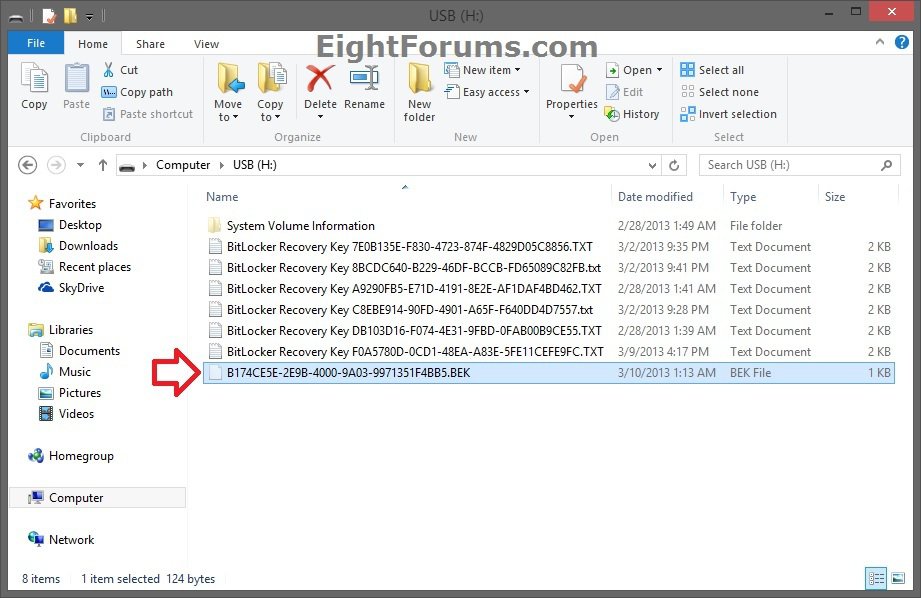

EXAMPLE: BitLocker Startup Key
NOTE: The startup key is saved as a .BEK file on the USB flash drive. The .BEK file is a hidden protected OS file. Only when you have a USB flash drive with the startup key saved to it connected during boot will it automatically unlock the OS drive to allow Windows 8 to startup.

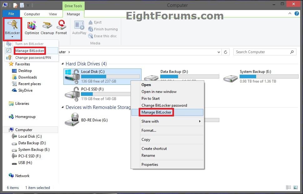

3. In File Explorer, open Computer, right click or press and hold on the encrypted Windows 8 drive, click/tap on Manage BitLocker, and go to step 5 below. (see screenshot below step 4)
4. In File Explorer, open Computer, select (highlight) the encrypted Windows 8 drive, click/tap on Manage (Drive Tools) tab, click/tap on BitLocker icon in the ribbon, click/tap Manage BitLocker, and go to step 5 below. (see screenshot below)

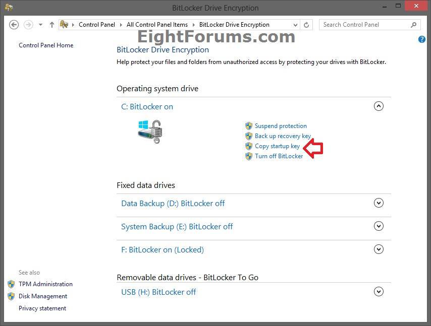

5. Under Operating system drive, click/tap on the arrow to expand the Windows 8 OS drive, and click/tap on the Copy startup key link. (see screenshot below)

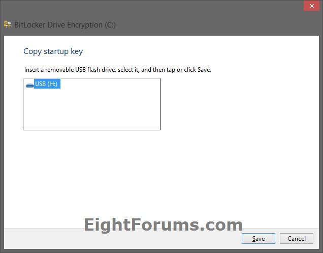

7. Connect the USB flash drive, select it, and click/tap on Save. (see screenshot below)
