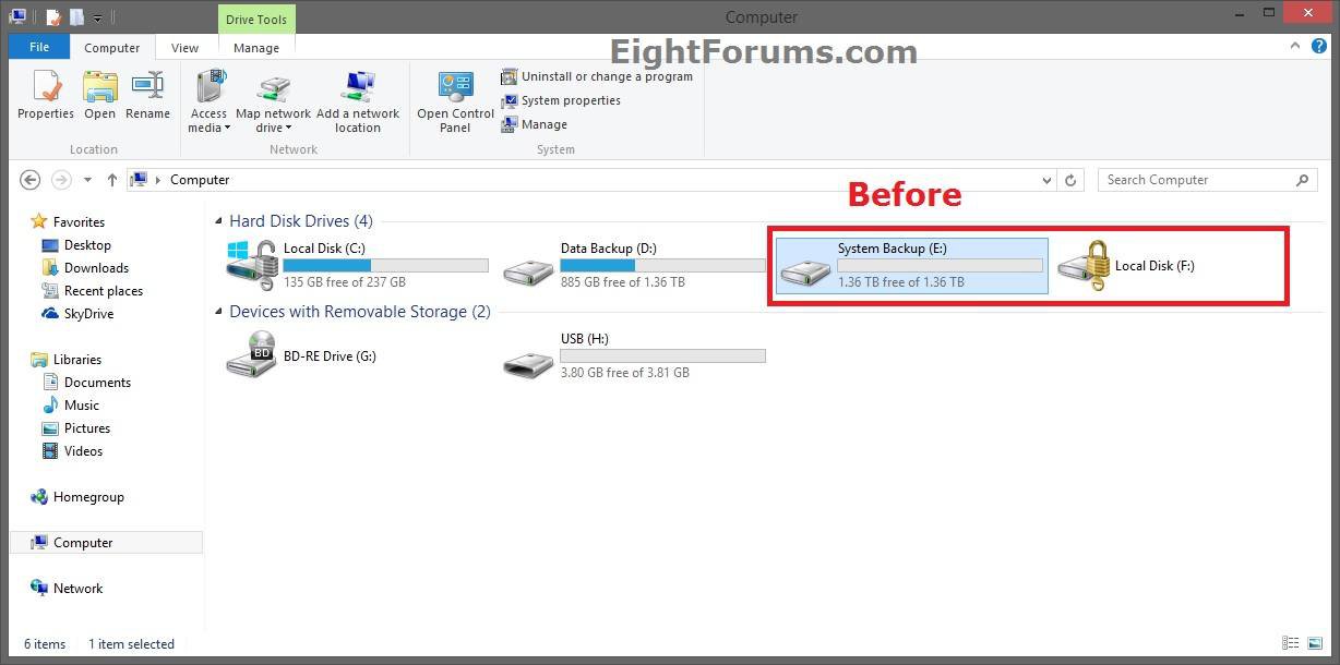

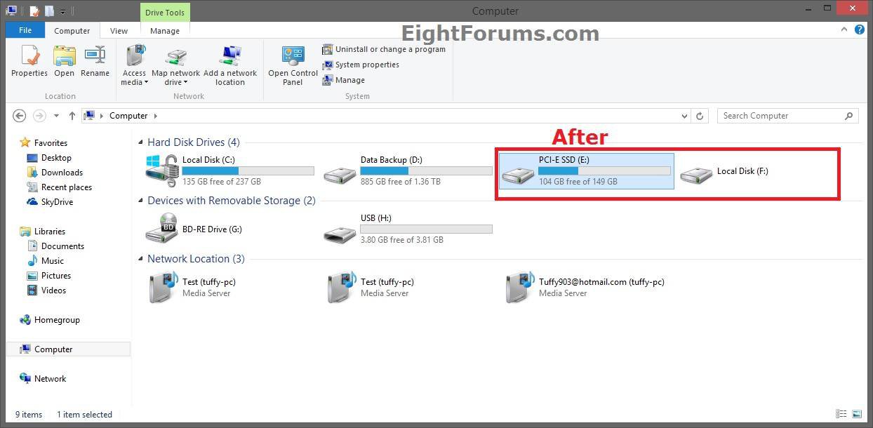

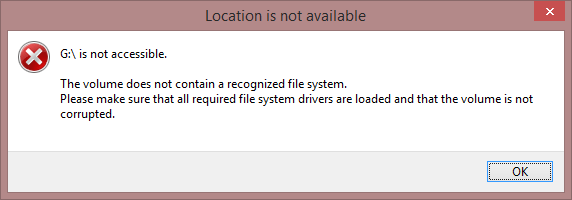

EXAMPLE: Before and After using BitLocker Repair Tool
NOTE: In this example, the BitLocker encrypted drive is F: and the output volume is E: .

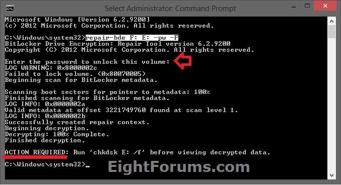

2. To Use the Password in Windows 8
NOTE: This option is only available in Windows 8, and would be for an OS drive, fixed data drive, or removable data drive that you have configured to be unlocked by a password.
A) Open an elevated command prompt.
B) In the elevated command prompt, type the command below, and press Enter. (see screenshot below)
repair-bde F: E: -pw -F
Note
C) When prompted in the command prompt, type the recovery password for this encrypted drive, press Enter, and go to step 5 below.
NOTE: You will not see the password as you type it.

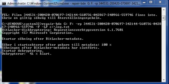

3. To Use the Recovery Key in Windows 7 and 8
NOTE: This would be for an OS drive, fixed data drive, or removable data drive that you still have the recovery key either saved to your Microsoft account, saved to a file, saved to a USB flash drive, or printed.

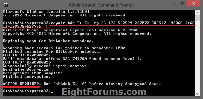

B) In the elevated command prompt, type the command below, press Enter, and go to step 5 below. (see screenshot below)
repair-bde F: E: -rp BitLockerRecoveryKey -F
For example:

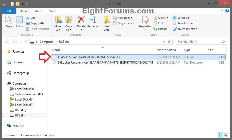

4. To Use the Startup Key in Windows 7 and 8
NOTE: This would only be for an OS drive that you have configured to be unlocked by a USB flash drive.
A) Since you will not be able to boot from the OS drive, you will need to first connect it to another Windows Server 2008 R2, Windows 7, Windows Server 2012, or Windows 8 PC.
B) Open an elevated command prompt in the other PC.

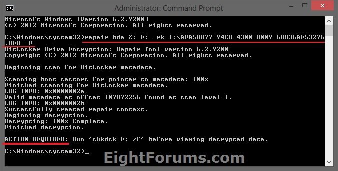

C) In the elevated command prompt, type the command below, press Enter, and go to step 5 below. (see screenshot below)
repair-bde F: E: -rk I:\StartupKey.BEK -F
For example:
Note

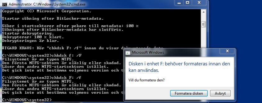

5. When finally successfully finished, follow any given "ACTION REQUIRED" first. For example, to run chkdsk on the output volume before opening. (see screenshots below step 2, 3, and 3 above)
NOTE: The BitLocker Repair Tool may take a long time to finish, but you will still be able to use your PC during the recovery process. Just do not turn off the PC until it has finished.
6. You will now be able to open the output volume (ex: E) to view the decrypted files from the BitLocker encrypted drive (ex: F).

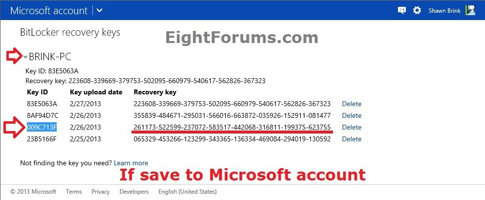

If you were signed in to your Microsoft account when you encrypted a drive with BitLocker, then you can get your recovery key from your OneDrive at the link below.
Microsoft account: BitLocker recovery keys
For only items in red in the command above:
Substitute F for the drive letter of the Bitlocker encrypted drive. Not the last F.
Substitute E for the drive letter of the output volume you want to have the contents of the Bitlocker encrypted drive decrypted and copied to.

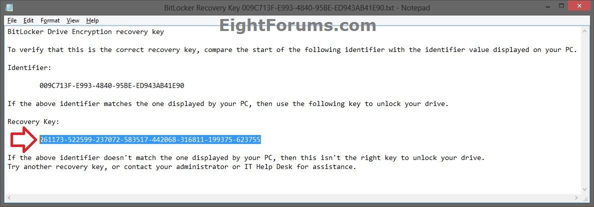

For example:
repair-bde [COLOR=#ff0000][B]F[/B][/COLOR]: [COLOR=#ff0000][B]E[/B][/COLOR]: -rp [COLOR=#ff0000][B]261173-522599-237072-583517-442068-316811-199375-623755[/B][/COLOR] -F

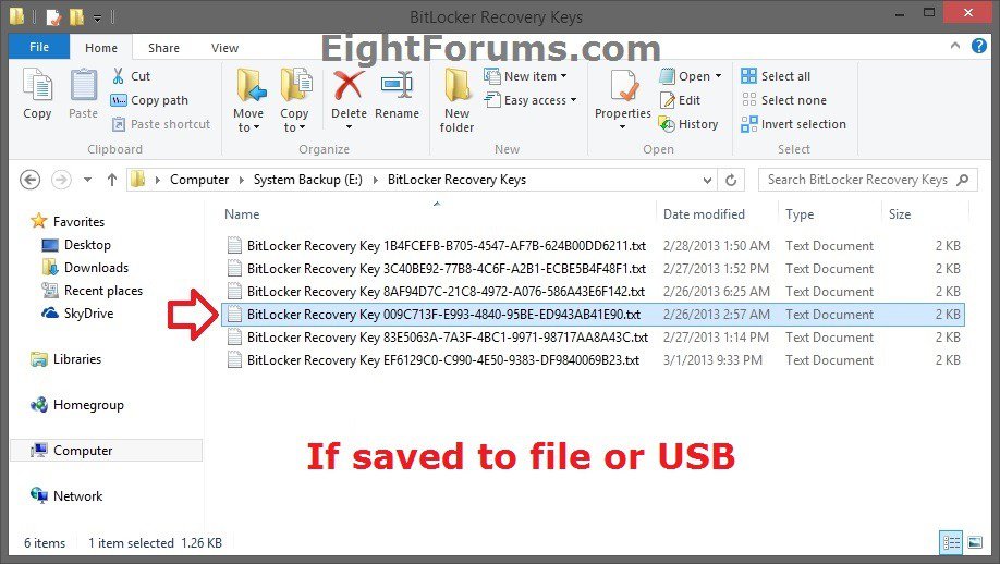

Substitute BitLockerRecoveryKey for the actual 48 digit recovery key for the encrypted drive like below.
Saved to USB or File:
Saved to Microsoft account:
For example:
repair-bde [COLOR=#ff0000][B]Z[/B][/COLOR]: [COLOR=#ff0000][B]E[/B][/COLOR]: -rk [COLOR=#ff0000][B]I[/B][/COLOR]:\[COLOR=#ff0000][B]AFA58D77-94CD-4300-8009-68B36AE53276[/B][/COLOR].BEK -F
Substitute I for the USB drive letter that the startup key has been saved or copied to.
Substitute StartupKey for the actual file name of the startup key for the encrypted drive like below. The BEK file (startup key) will be a hidden protected OS file.
