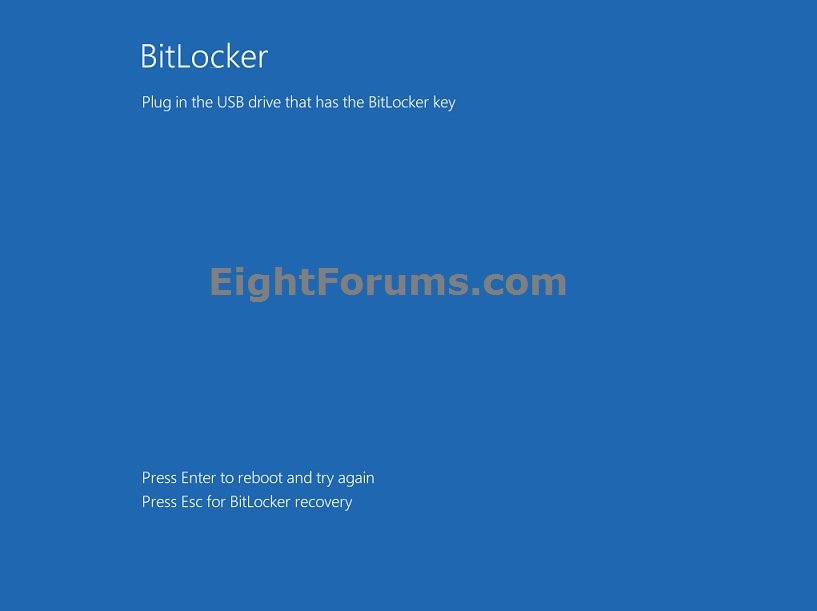

2. If to Insert a USB Flash Drive

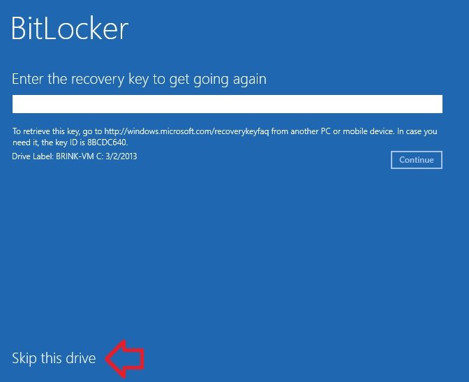

A) At boot when prompted to plug in the USB flash drive that contains the startup key, click/tap on Press Esc for BitLocker recovery, and go to step 4 below. (see screenshot below)​

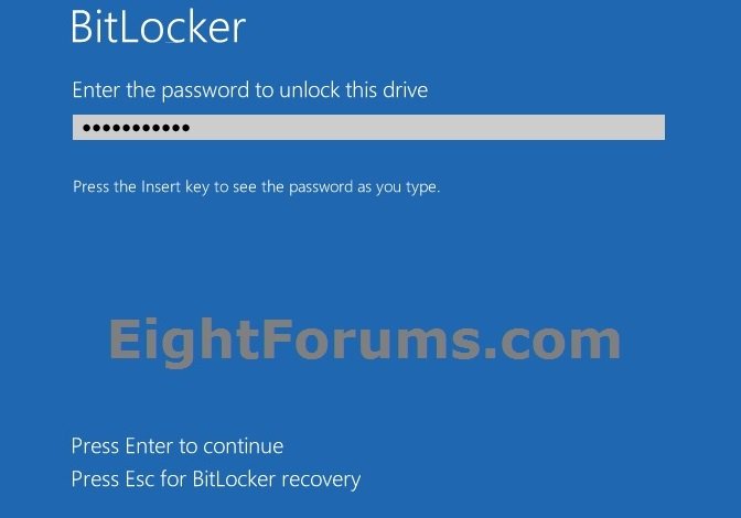

3. If to Enter a Password
A) At boot when prompted to enter the password, click/tap on Press Esc for BitLocker recovery, and go to step 4 below. (see screenshot below)​
4. In BitLocker recovery, look to see what the first part of the Recovery key ID number (ex: 8BCDC640) is. This number is what you will use to reference the correct BitLocker recovery key to enter. (see screenshot below)​

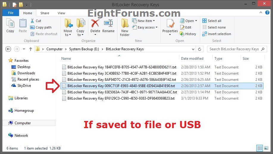

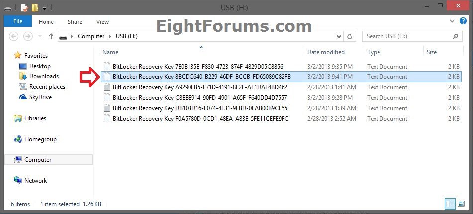

7. If you Saved the Recovery Key to a File or USB Flash Drive

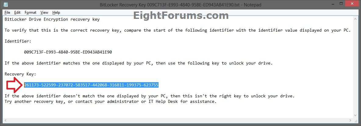

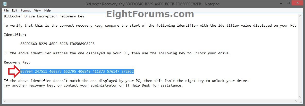

A) On another PC, open the file or USB drive, open the BitLocker Recovery Key..... file that has the same first part of the Recovery key ID number (ex: 8BCDC640) from step 4 above, and go to step 9 below. (see screenshots below).​

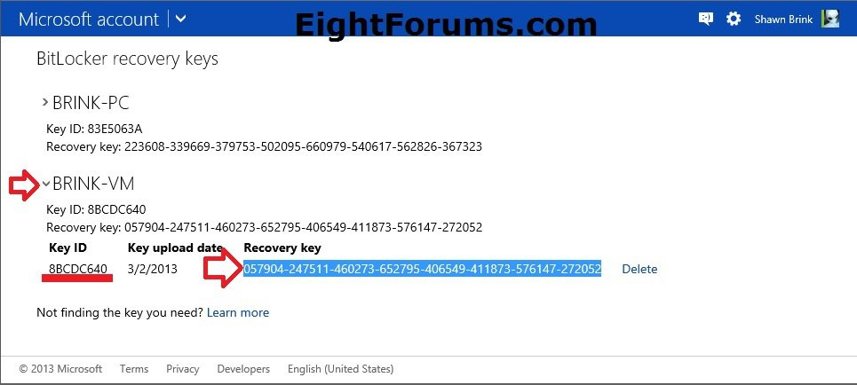

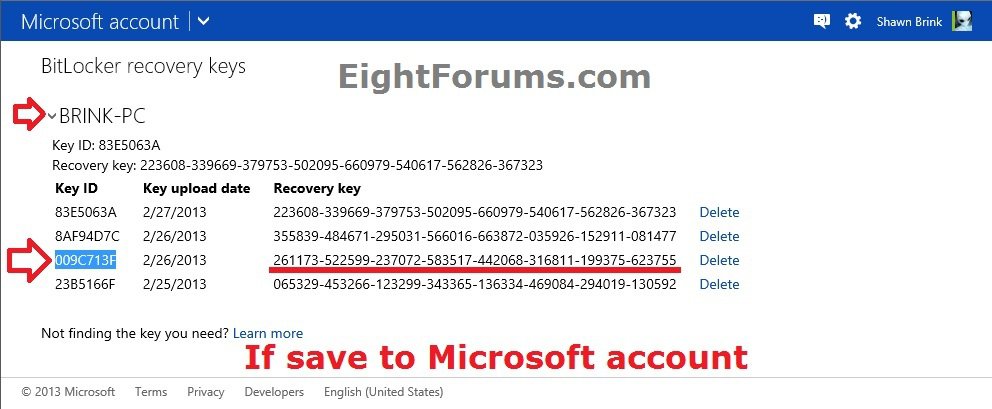

8. If you Saved the Recovery Key to your Microsoft Account Online
A) On another PC, go to the link below to sign into your Microsoft Account online and view your saved BitLocker recovery keys.​
B) Expand the computer name (ex: BRINK-VM) arrow for the one you want to unlock, and look for the BitLocker recovery key that is for the same first part of the Recovery key ID number (ex: 8BCDC640) from step 4 above, and go to step 9 below. (see screenshot below)​
9. Enter the full 48 digit BitLocker recovery key, and press Enter. (see screenshot below step 4)​
10. If successful, the OS drive should now be unlocked to allow Windows 8 to start.​

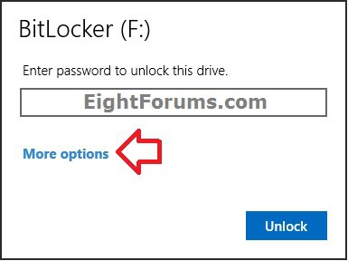

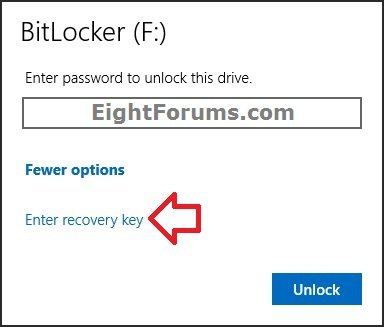

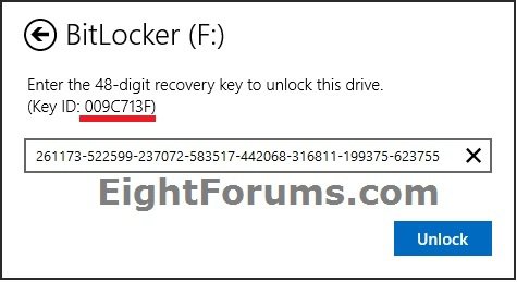

1. In Windows 8, open the locked data drive to have it prompt you to enter the password to unlock it, and click/tap on More options. (see screenshot below)​
2. Click/tap on Enter recovery key. (see screenshot below)​
3. Look to see what the first part of the recovery key ID number (ex: 009C713F) is. This number is what you will use to reference the correct BitLocker recovery key to enter. (see screenshot below)​

6. If you Saved the Recovery Key to a File or USB Flash Drive
A) Open the file or USB drive, open the BitLocker Recovery Key..... file that has the same first part of the Recovery key ID number (ex: 009C713F) from step 3 above, and go to step 8 below. (see screenshots below).​
7. If you Saved the Recovery Key to your Microsoft Account Online
A) Go to the link below to sign into your Microsoft Account online and view your saved BitLocker recovery keys.​
B) Expand the computer name (ex: BRINK-PC) arrow for the one you want to unlock, and look for the BitLocker recovery key that is for the same first part of the Recovery key ID number (ex: 009C713F) from step 3 above, and go to step 8 below. (see screenshot below)​
8. Enter the full 48 digit BitLocker recovery key, and press Enter. (see screenshot below step 3)​

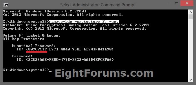

How to Unlock a Data Drive with BitLocker Recovery in Command Prompt
NOTE: You must be signed in as an administrator to be able to do this option. This will apply to fixed and removable data drives.
2. In the elevated command prompt, type the command below, and press Enter.​
NOTE: This will let you see what the Numerical Password (aka: recovery key ID) number (ex: 009C713F) is for this drive. This number is what you will use to reference to enter the correct BitLocker recovery key at step 7 below.​
manage-bde -protectors F: -get
NOTE: Substitute F in the command with the drive letter of the locked data drive you want to unlock.​

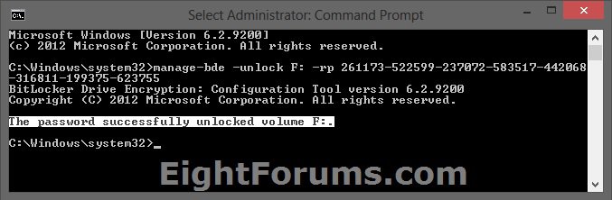

7. In the elevated command prompt, type in the command below with the 48-digit Bitlocker recovery key. (see screenshot below)​
NOTE: Substitute F in the command below with the drive letter of the locked drive you want to unlock, and substitute BitLocker Recovery Key in the command below with the actual 48 digit BitLocker recovery key from step 4, 5, or 6 above.
manage-bde -unlock F: -rp BitLocker Recovery Key
For example: If I wanted to unlock the F data drive with the 261173-522599-237072-583517-442068-316811-199375-623755 BitLocker recovery key number, I would type this below exactly and press Enter.​
manage-bde -unlock [COLOR=#ff0000][B]F[/B][/COLOR]: -rp [COLOR=#ff0000][B]261173-522599-237072-583517-442068-316811-199375-623755[/B][/COLOR]
8. If successful, the data drive should now be unlocked.​

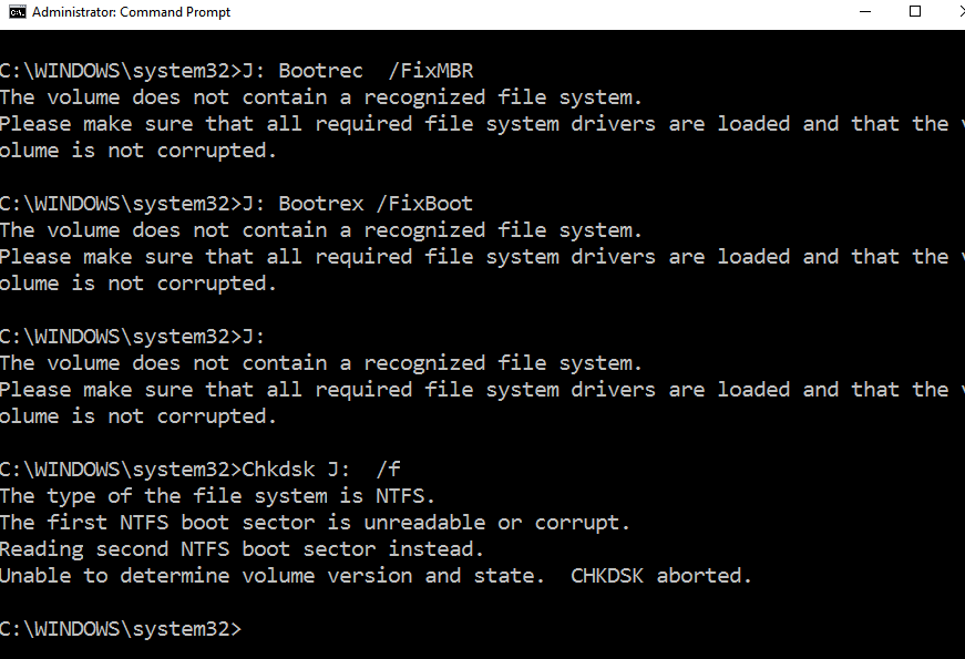

I did this mistake, I created a bootable USB by easy bcd and tested on host window during boot. Reached to the point where windows setup asks for disk selection, I clicked on the drive(setup says drive encrypted and can't continue) but didn't go further.
Then I boot nothing shows up.
Tried to connect 3tb hard to another PC to unlock drive but it's not accepting the correct password and recovery key.
I made windows image before encryption. After restoring that 2nd and 4th drives are not accessible, 5th is formatted and 3rd drive data is intact with minor data loss.
I ran testdisk-7.0 and found no drive in the quick search. The log file is pasted below.

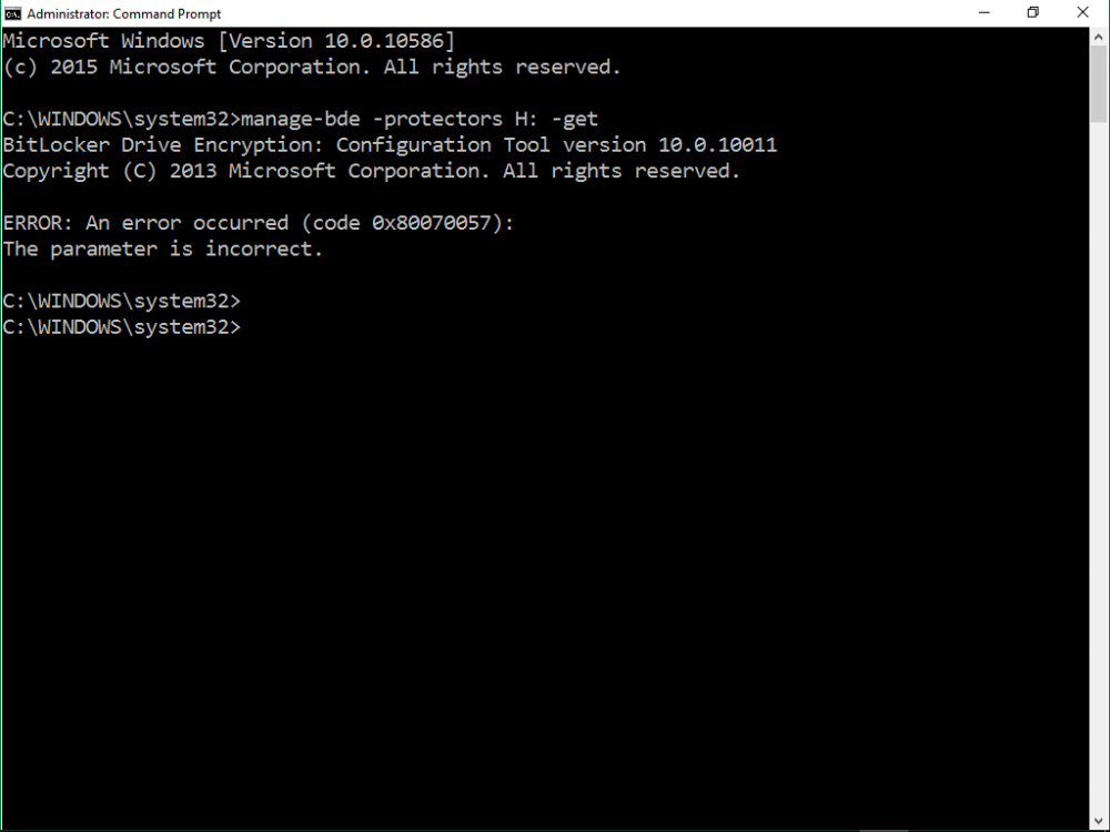

On given link, the drive shows BitLocker encryption sign but in my case not.
I tried cmd recovery before but no luck.

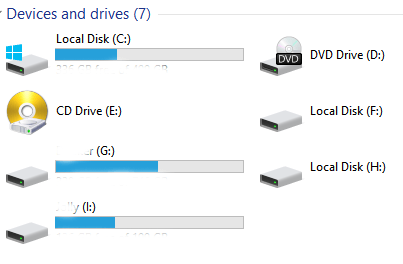

Here you can see my drives status in the screenshot.
Thanks.
Jillian,
The drives's icons don't indicate that they are encrypted by BitLocker in that screenshot. Are you able to open them now?

I am not able to open them. Before the issue bitlocker logo was visible.

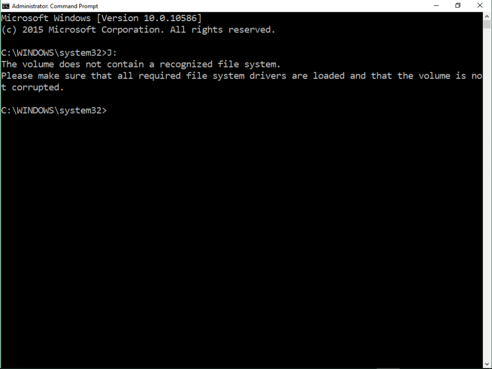

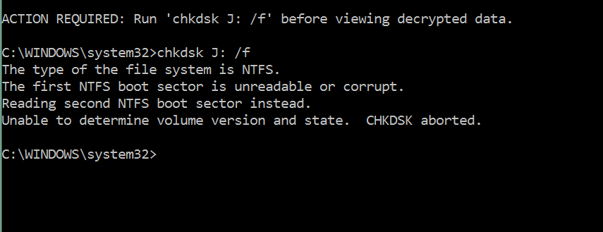

It says you need to format that drive before use.

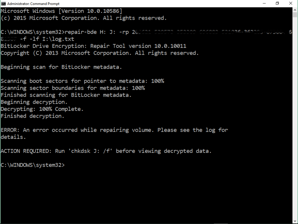

[FONT=&amp]I repaired Bitlocker using the following command[/FONT]
[FONT=&amp]
[/FONT]
[FONT=&amp]repair-bde H: J: -rp KEY -f -lf I:\log.txt[/FONT]
[FONT=&amp]
[/FONT]
[FONT=&amp]The following errors showed up
[/FONT]repair status.png
chkdisk status.png[FONT=&amp]
[/FONT]
[FONT=&amp]
Log file link is also given below.
log.txt :: Free File Hosting - File Dropper: File Host for Mp3, Videos, Music, Documents.
Thanks.
[/FONT]
The log is showing that it failed to decrypt data at several offsets on the drive.

I am thinking when I restored c, windows re-created all drives, mbr and boot sector of Bitlocker drives is disturbed. Backup was before encryption.
Can you confirm there is no issue with partition table?
Why one drive that was also encrypted out of 5 have data and readable?
Thanks.
Update to the case.
I ran below commands.
J:
Bootrec /FixMBR
Bootrex /FixBoot
Chkdsk J: /f chkdisk log.png
Looking for your expert opinion.
I think there is a software by Norton to remove bad starting sectors of a drive to read remaining data.
Thanks.
That may help normally, but I'm not sure when you have BitLocker involved. Hopefully someone may know more than me on this to further help.
Jillian,
It looks like the drive is toast. You may be able to format it to be able to use it again, but you will lose all data on it.
