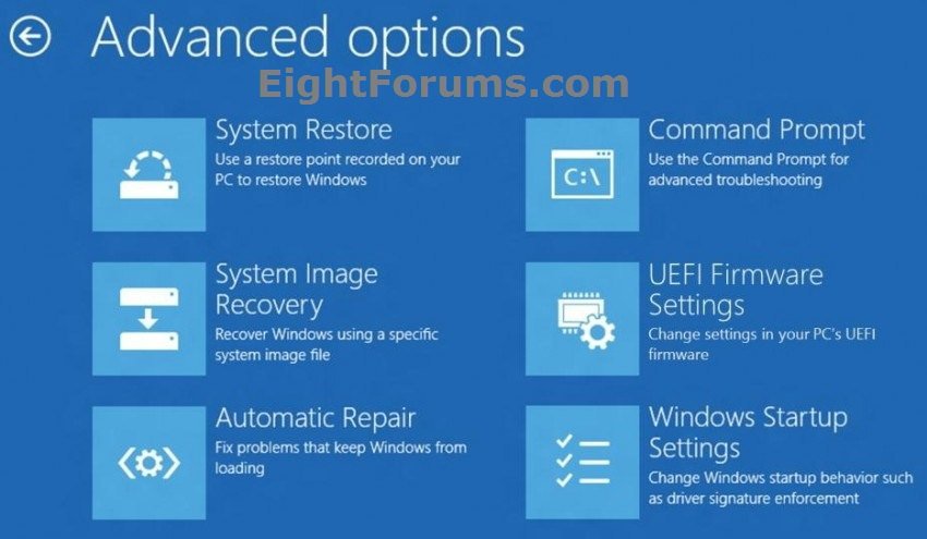

1. Boot to the System Recovery Options screen, and click/tap on Advanced options and Automatic Repair. (see screenshot below)
NOTE: Your PC may restart after this.

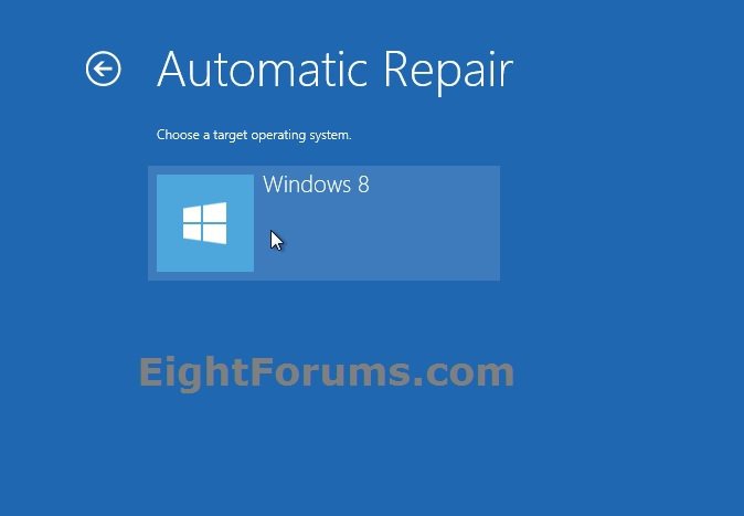

2. If prompted, choose the OS (ex: Windows 8) that you want to do an Automatic Repair on. (see screenshot below)
NOTE: You will usually only see this if you booted from a Windows 8 installation DVD or USB thumb drive, or ISO file if in a virtual machine.

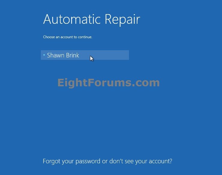

3. If prompted, select an administrator account. (see screenshot below)
NOTE: Standard user accounts and domain accounts on the computer will not be listed.

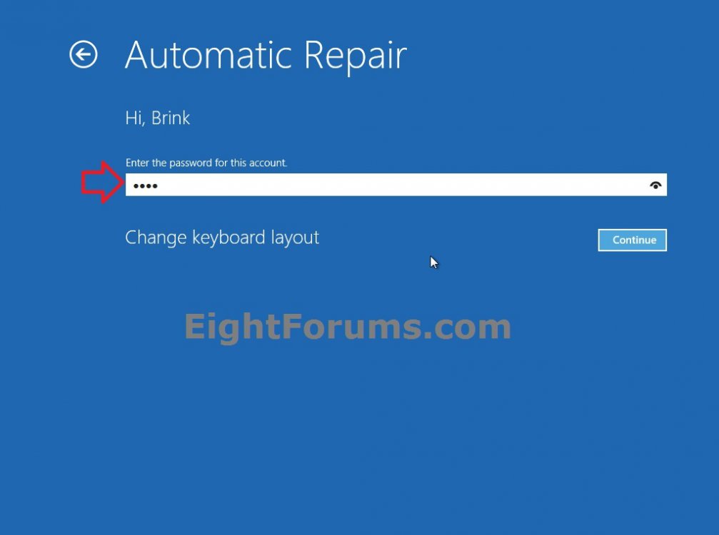

A) Type in the password for the selected administrator account, and click/tap on Continue. (see screenshot below)​
NOTE: If you need to change the keyboard layout (language), then do so before entering your password so it will be the same language that the password was set in and match.​

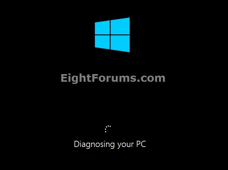

4. Automatic Repair will now start "Diagnosing your PC", and attempt to automatically repair them. (see screenshot below)
NOTE: Automatic Repair might prompt you to make choices as it tries to fix the problem, and if necessary, it might restart your computer as it makes repairs.

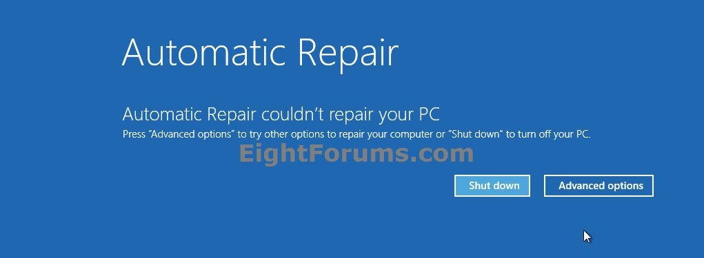

5. If startup repair could not find problems or repair your computer, then either click/tap on Shut down to turn off your PC, or click/tap on Advanced options to go back to step 1.
NOTE: Sometimes it may take to run Automatic Repair 3 times to fix the startup issue.
