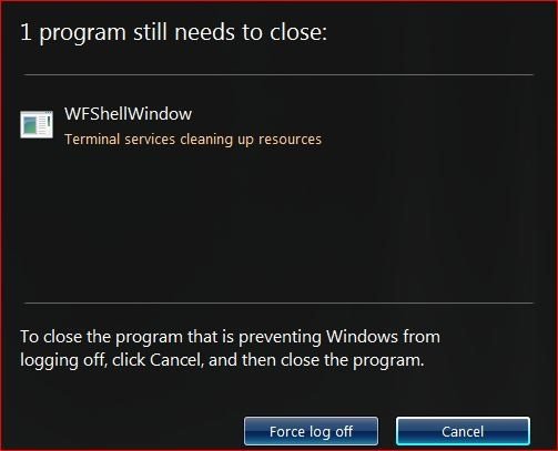

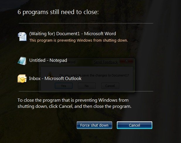

EXAMPLE: Force End Task Dialog at Shutdown

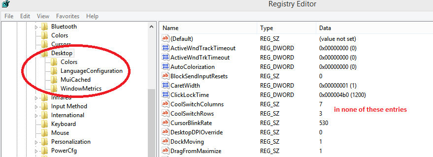

Shawn I am not getting that autoendtasks in my registry entries is that because I upgraded this machine from 7 to 8 then 8.1?

Hello John,
The AutoEndTasks string value is not there by default, and needs to be added to work.
