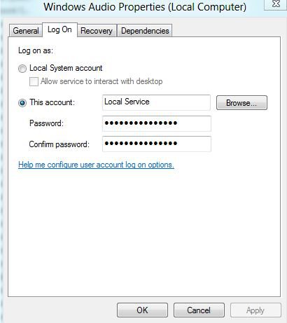

You can otherwise check that the service is set to Log On as the Local Service account. The service does not need to have the box checked to interact with the desktop.
Follow the advice here:
Configure How a Service Is Started
If you still have issues, it would be best to create a new account with Administrator privileges on the machine and log into it. Test that account out and see if the audio service start well.

This didnt help. Audio service is logged on to the local service only. I created another account with administrator privileges and tried changing the properties. Still having the same problem and the same error 1297 pop up message appears.

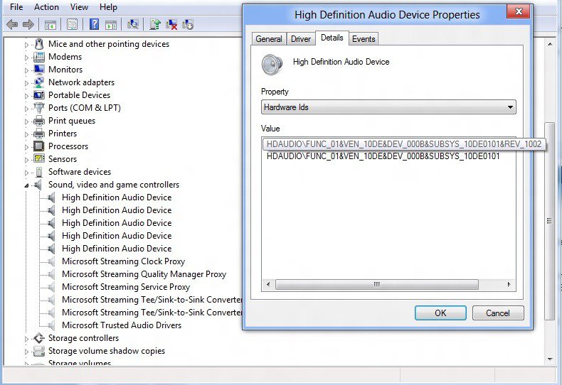

In device manager, right click your audio adapter. Choose Properties then go to Details tab. Change the dropdown to say hardware ids. Copy/paste the results here.

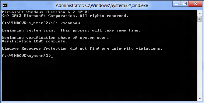

After doing so, it is a good idea to run this command from an elevated (Admin) command prompt to ensure all OS files are well. If you applied any patches such as ones to remove the desktop watermark, it will undo them:
sfc /scannow

These are the devices that are shown in my device manager. I dont have a speaker so i use my headphones that is listed here. I changed the dropdown in this to hardware ids.
After running sfc /scannow i got this:

That is not the device manager, however. The device manager can be found by right clicking on the lower left corner of your screen.
I need to know the hardware id as requested to find you a driver to install. If there doesn't seem like there is anything like the audio adapter while expanding (double clicking) the Sound section of the device manager - then look to do so for the "unknown device" instead.

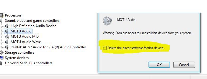

See all those listings in the Sound, video and game controllers section?

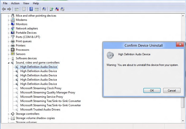

Right click on each and every one of them and choose to uninstall it. While doing so, also check the box to delete the driver.
When done, reboot. Then install this. It will be fine:
Realtek <<<< Get the top one shown.
Good luck and enjoy.

After you right click them then left click uninstall, this shows:

Cool. Just press OK then.

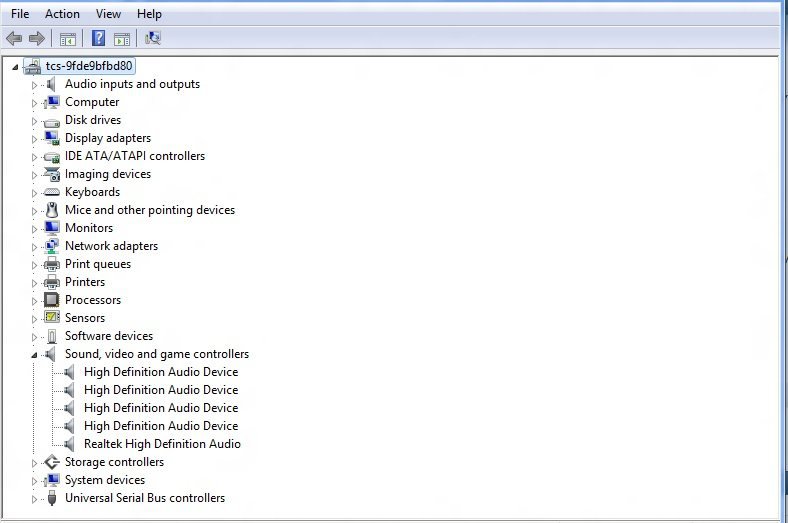

Still i cant start the audio to work. I uninstalled the listings under the Sound, video and game controllers section. Then restarted the pc, then installed the driver that u had asked me to. There is still that red 'x' icon on the audio service key on the taskbar.
    Windows 8 Consumer Preview
You can post a new screenshot of the device manager if you wish.

The device manager as u requested.

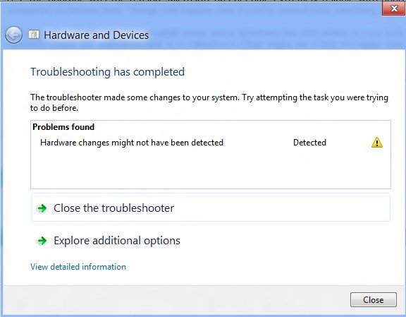

DVD Problem - eh - not really a problem. Follow this. Scroll down to "let me fix it myself":
Your CD drive or DVD drive is missing or is not recognized by Windows or other programs
If it doesn't work, then type msinfo32 in start and press enter. File | save on the opened screen. Zip or rar the saved file and attach here.

The solution in the link given didnt work out. This was what i got:
