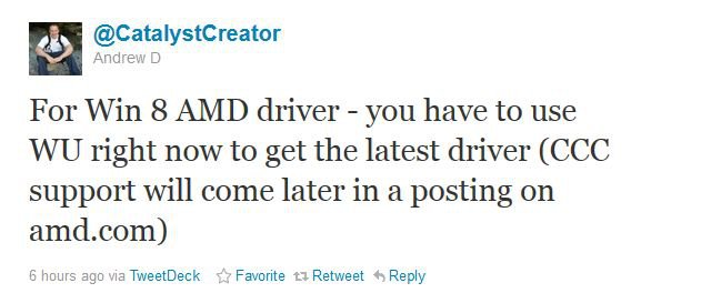

However - when I try to install the Catalyst Control Center with the express option, it seems to go through the motion and then says it installed it, but the folders are empty and it's not there. If I try to use the custom option it tells me "failed to find any installable components!", but the drivers and the card are both working just fine. I was just wondering if anyone else had this issue or knows a way around the downscaling without installing the control center. Those black borders are really annoying, I think it might be some sort of factory default set to -15% or so. Any information that might help solve this would be appreciated.
And that from @CatalystCreator posted today...
https://twitter.com/#!/CatalystCreator
@Jack Sparrow: Thanks mate! Took a look, but my problem is with downscaling, not fan speed. They do have good ideas though, I will simply keep trying different versions of the program to see if any of them work.
