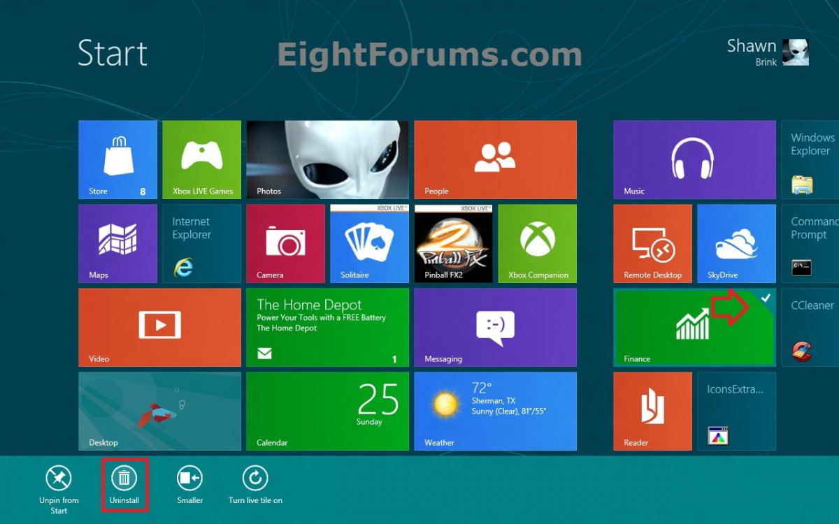

2. Open your Start screen, right click on a single app (ex: Finance) that you would like to uninstall to select (check) it, click/tap on Uninstall in the bar at the bottom, and go to step 4 below. (see screenshot below)
NOTE: For touchscreen users, you would need to swipe the app's tile to open the options bar at the bottom instead.

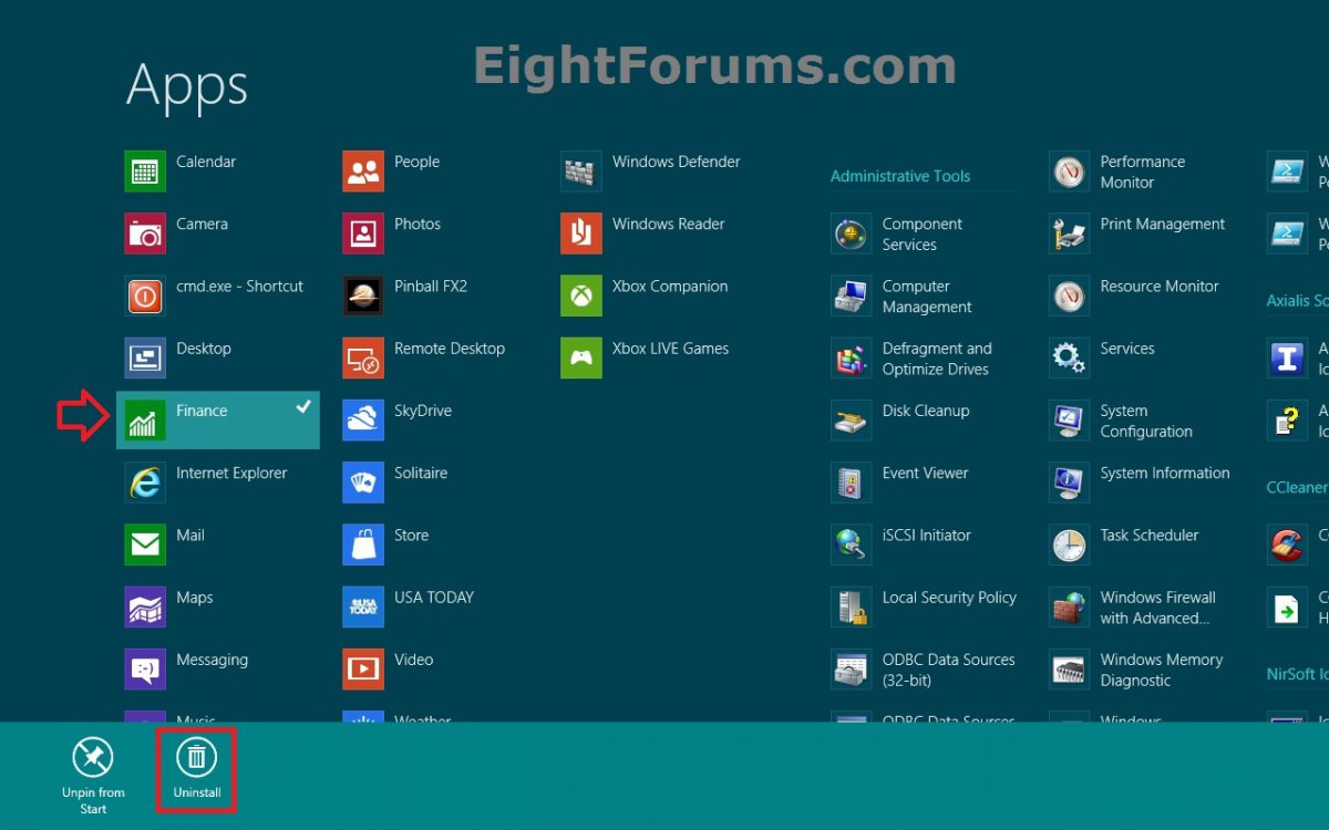

3. Open your Apps screen, right click on a single app (ex: Finance) that you would like to uninstall to select (check) it, click/tap on Uninstall in the bar at the bottom, and go to step 4 below. (see screenshot below)

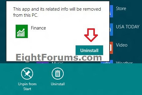

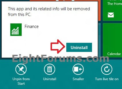

4. Click/tap on the Uninstall button in the pop-up box. (see screenshots below)
5. The app have now been uninstalled from your Microsoft account.

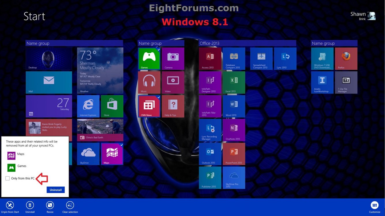

2. Open your Start screen to either the Start or Apps view.

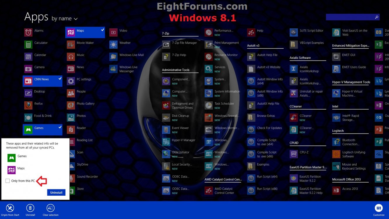

A) Right click on one or more apps (ex: CNN News, Games, Maps) that you would like to uninstall to select (check) them, click/tap on Uninstall in the bar at the bottom, and go to step 4 below. (see screenshots below)

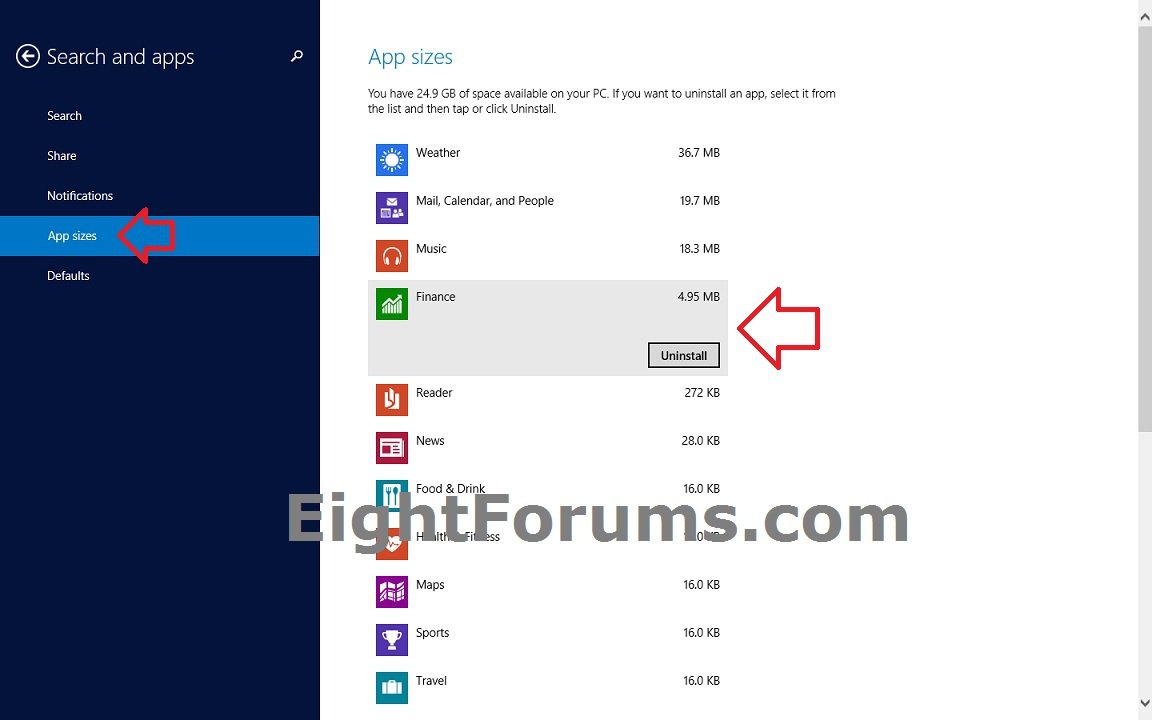

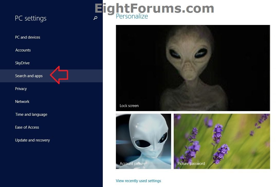

3. Open PC settings, and click/tap on Search and apps on the left side. (see screenshot below)
A) Click/tap on App sizes on the left side of "Search and apps", click/tap on the app you want to uninstall on the right side, click/tap on the Uninstall button, and go to step 4 below. (see screenshot below)

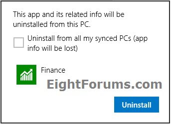

4. If you want to uninstall the listed app(s) from all synced PCs and not only from this PC, then check the Uninstall from all my synced PCs box in the pop-up dialog. (see screenshot below)
NOTE: Your synced PCs would be all the PCs that you sign in with the same Microsoft account and have set apps to sync on each PC.
5. Click/tap on the Uninstall button in the pop-up dialog. (see screenshot above)
6. The app(s) have now been uninstalled from your Microsoft account or only from this PC.

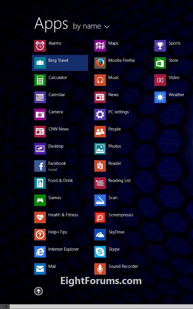

1. Open your Apps screen and verify the name of the modern app (ex: Bing Travel) you want to uninstall from only your account on the PC. (see screenshot below)

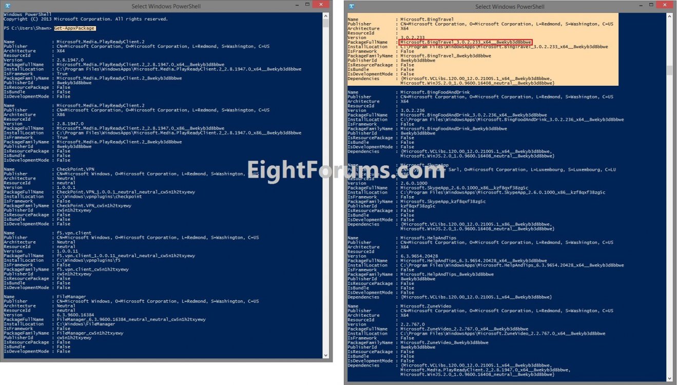

2. Open PowerShell, copy and paste the command below, and press Enter. (see screenshot below step 3)
NOTE: This will give you a list of all installed modern apps for your account on the PC.
Get-AppxPackage
3. Scroll through the list of installed apps and look for the PackageFullName of the app (ex: Bing Travel) you want to uninstall. (see screenshot below)
For example: Microsoft.BingTravel_3.0.2.233_x64__8wekyb3d8bbwe

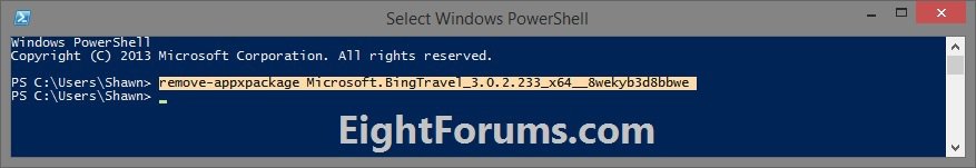

4. In PowerShell, type the command below, and press Enter. (see screenshot below)
remove-appxpackage PackageFullName
NOTE: Substitute PackageFullName in the command above with the app's actual PackageFullName like below from step 3 above. For example:
remove-appxpackage Microsoft.BingTravel_3.0.2.233_x64__8wekyb3d8bbwe
5. You will notice that the modern app (ex: Bing Travel) will no longer be listed on your Apps screen since it has been uninstalled for only your account now.
