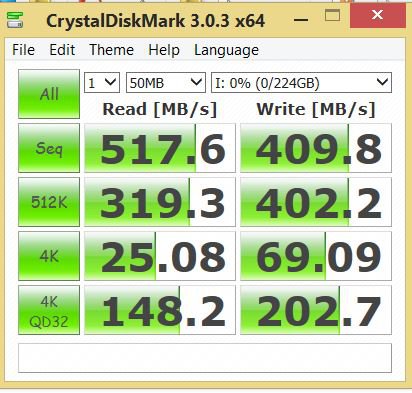

Average SSD (One of mine)

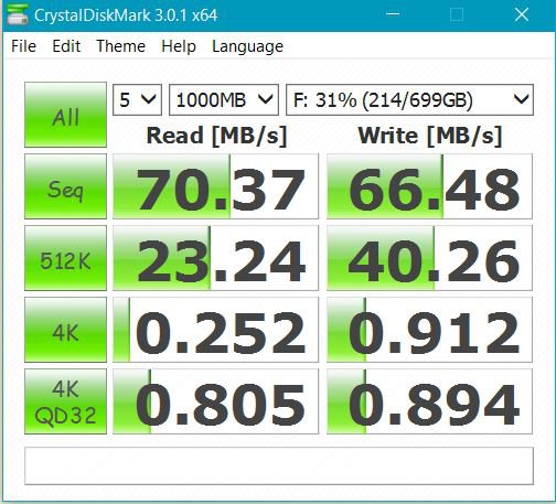

Western digital Green 750GB HDD (one of mine )
To say nothing about access time which is about 1000 times faster with SSD.
