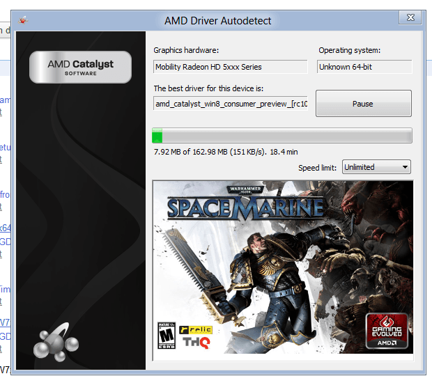

have you tried this? AMD Catalyst Drivers Windows 8 Consumer Preview
i have the same graphics card as you but i am not sure what the "switchable graphics application"
Downloading now to try it out. Hopefully it will work. :)

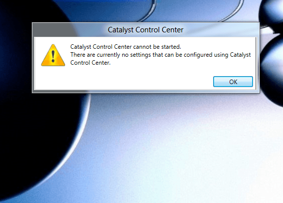

I installed the catalyst, and it installed great with no errors. However, when I start my computer, I get this message window on my desktop saying:
"The Catalyst Control Center is not supported by the driver version of your enabled graphics driver. Please update your AMD graphics driver, or enable your AMD adapter using the Displays Manager"
The device still cannot start.
I have the exact same problem / message ""The Catalyst Control Center is not supported by the driver version of your enabled graphics driver. Please update your AMD graphics driver, or enable your AMD adapter using the Displays Manager"
HELP!
^ Yep, that's the message I'm getting. I was just popping in to see if AMD has fixed this issue yet?

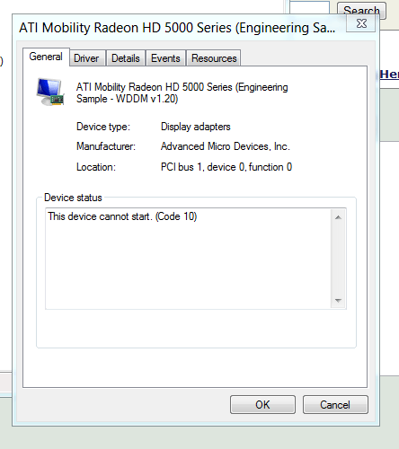

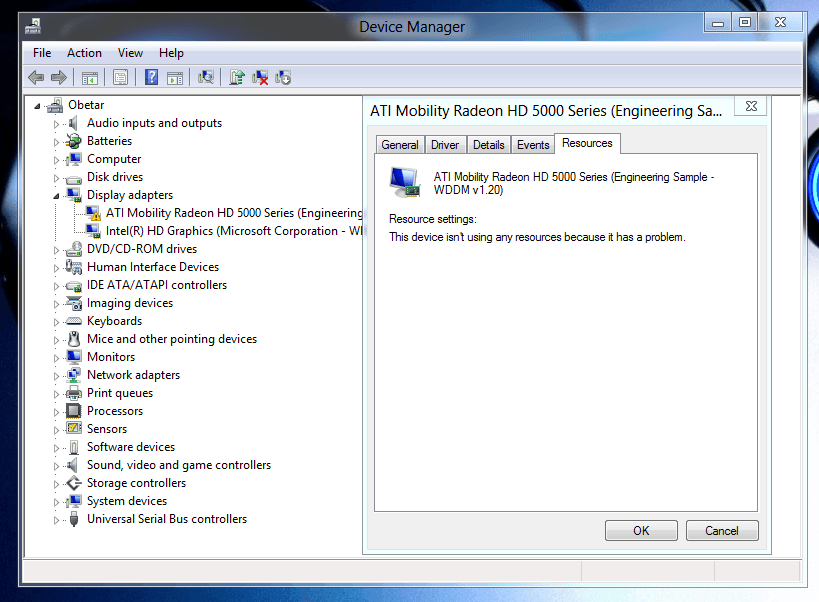

Obetar, did the driver install well for you? I see the code 10 but it isn't clear to me if it did, AFTER that or not.
Anyway, if it did install well and now you only need CCC - you should try deleting all ATI folders in Program Files and Program Files (x86) and also delete all ATI/AMD files in C:\Windows\System32 - check the properties before deleting though to ensure its only an ATI/AMD file.
Then try to install CCC from here after:
AMD Catalyst 12.3 (8.951.0 March 8) AMD Official WHQL drivers
I don't expect success and am just giving you an idea to try. If it works, then more power to ya.
