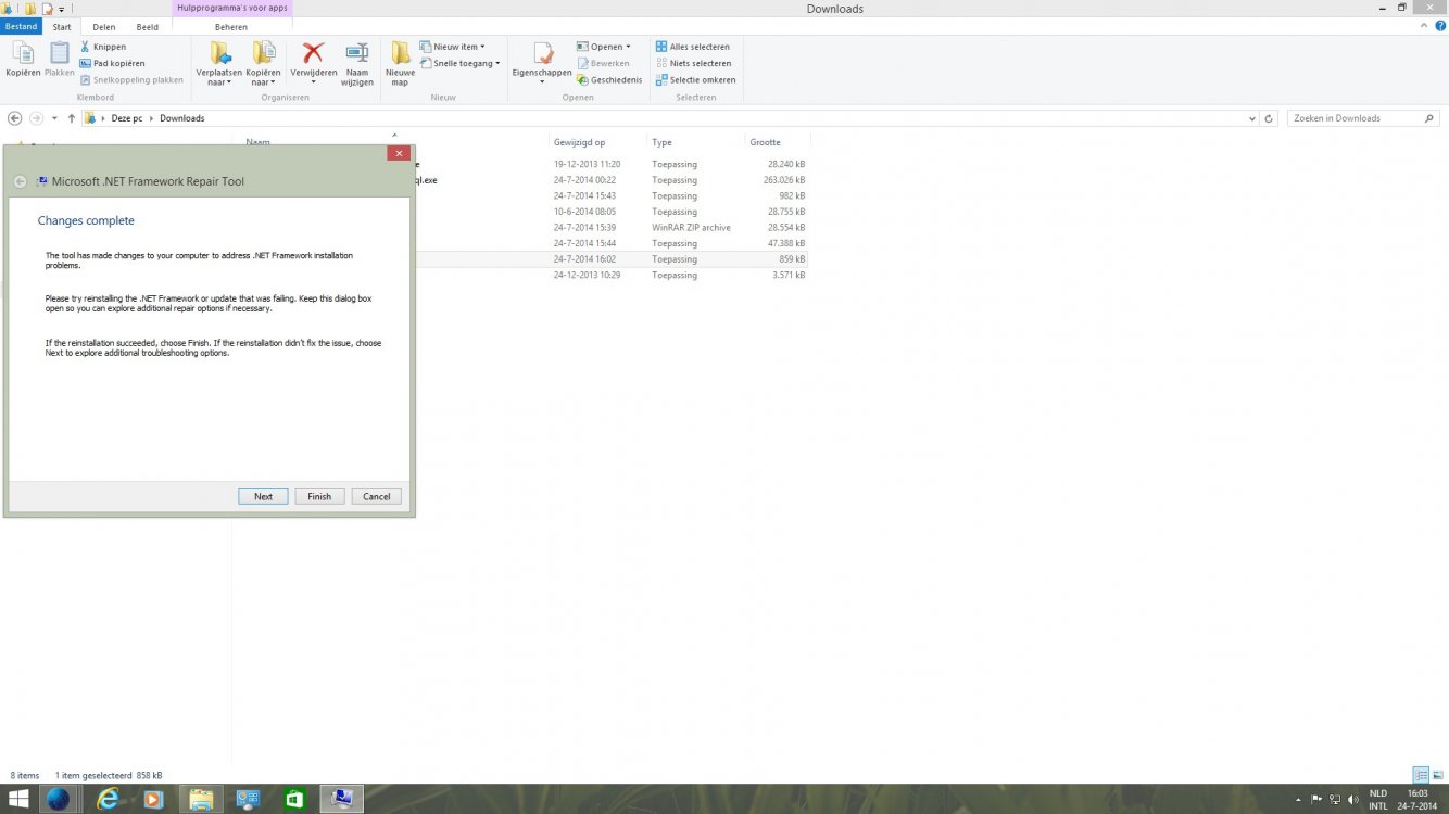

I've tried, but I don't understand so much. I made a picture and I've chosen for next. microsoft .net framework repair tool.jpg

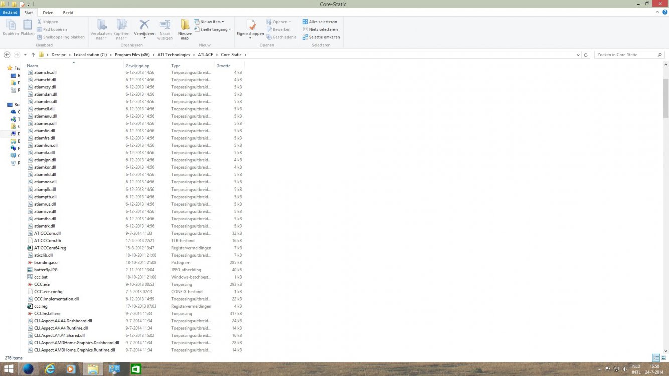

I removed everything of amd, but I would say that there is a folder remains of amd (ati technologies) in program files x86 that I can't remove. Maybe that's the problem and how can I remove it. It says that the application is open and therefore I can't remove.map amd 86x.jpg
Great, I made it finally. You really need to try removing everything of amd. I've looked at amd files through task management. Press properties and must refer to something windows: system 32, there is somewhere a few files from ati (amd) you need to remove all. Then reboot your PC and install all the drivers again. Then it must work. Thank you all for your help.
