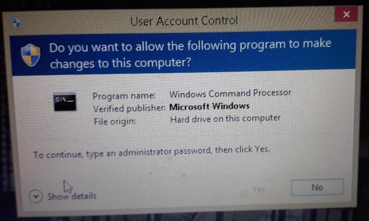

When I try to edit or add anything on my Windows 8.1, this message pops up and I can't delete anything. Any help is welcome
The UAC message is asking for administrator approval to run this program. In this case it was cmd.exe you were running, and I assume you were trying to run it as an administrator.
If you are signed in as an administrator you could just click the 'Yes' button at this point. If you are signed in as a standard user you would be asked for the name and password of another administrator account before you could click 'Yes'.
Neither of those are happening for you, the 'Yes' button looks greyed out, meaning you cannot click it.
This means that there are no administrator accounts on this PC. Usually this is because a user has either deleted their only administrator account, or they have demoted their only user account from an administrator to a standard user. As you have found, you need at least one administrator account on a PC to be able to use it fully.
Your best option is to enable the built-in account named Administrator. Then sign in as Administrator (by default it has no password) and promote your user account back to being an administrator.
To enable the built-in Administrator you'll need to use Option Two in this tutorial.
When you are back to normal, create a second user account and make it an administrator so that you don't get stuck like this again. You can then disable the built-in Administrator account.

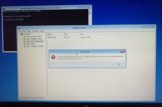

Hope you can see this picture.
I've logged in on safe mode, but now it says SAM is already being used so I can't open it.
You cannot open the SAM while you are booted into the same Windows that you are trying to do the work on.
Your Windows must not be running at all. To work on its SAM you must boot from something else, the 'something else' can be either a Windows install DVD or USB, or your Windows own built-in System Recovery Options.
Step 1 of Option Two in the first tutorial I gave a link for says...
The blue text is link to another tutorial that tells you how to do that. The easiest to use would be the system recovery options, as that is already part of your system. See step 3 in the 'boot to command prompt' tutorial.
Once you have booted to a command prompt you can run Regedit from the command prompt and follow the rest of Option Two in the first tutorial.

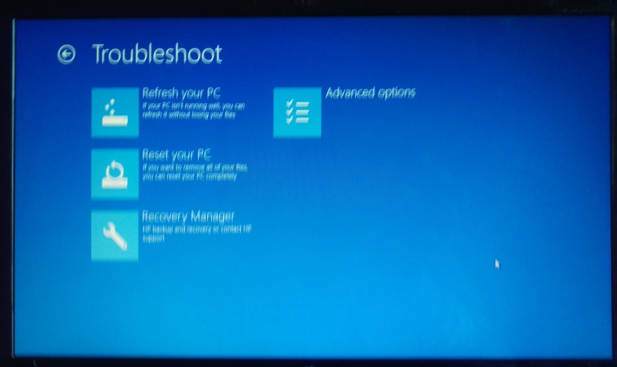

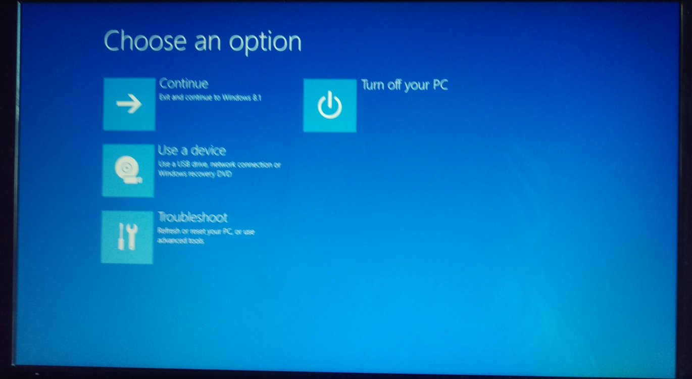

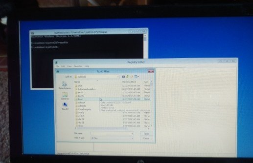

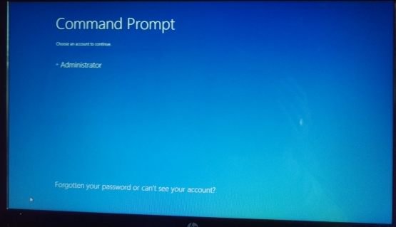

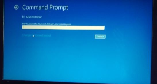

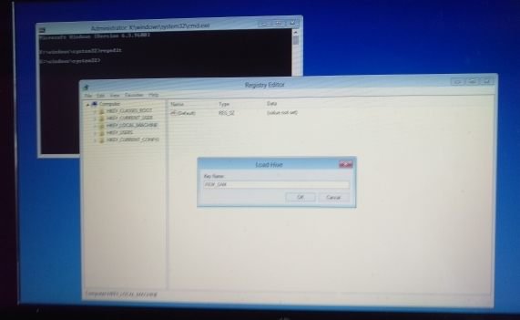

martinalison
7
This is how I'm following the process, somehow I've created an admin password. Should I therefore be doing it a different way
    HP
Bree
141
This is confusing. You are following the steps correctly, but at your image 3 it is asking you to choose an administrator account to sign in with. This would normally list any and all administrator accounts on the PC. It is offering just the built-in account named Administrator, so it appears that it is already enabled and you don't need to use @Brink's tutorial to enable it. There are no other administrator accounts on this PC or you'd have seen the in that list.
It is not recommended to use the built-in Administrator account as a regular account for daily use. You should have another account for that. If that account is also an administrator it will also be able to manage the PC.
What account were you signed in with for the screenshot in your post #1? Are there any other accounts on this PC? If so, then they are all standard users else they would also have appeared in your image 3.
Can you start up Windows normally and sign in to the built-in Administrator account? Do you have another account for daily use? If so, when signed in as Administrator promote you other account to an administrator, then sign in to that and see if you can now do everything you'd expect.

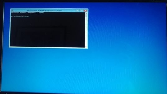

I noticed when I go into the command prompt through the administrator, my shows the commands been in "X" drive instead of "C" drive which your picture shows.
