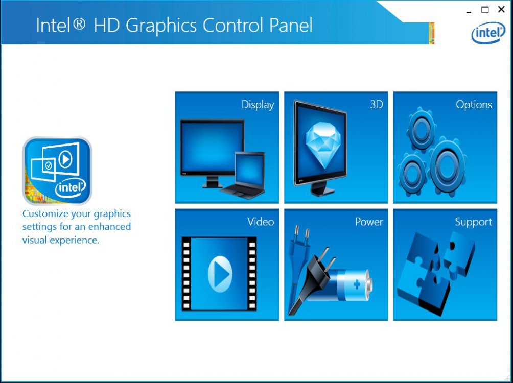

Enable or Disable Adaptive Brightness in Intel Graphics Control Panel
NOTE: This option is only if you are using Intel HD graphics on your PC. You may need to do it in addition to the options above. If you are using NVIDIA or AMD graphics instead, then this does not apply to you.
2. Click/tap the Power icon, and do step 3 or 4 below for what you would like to do.​

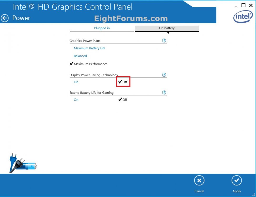

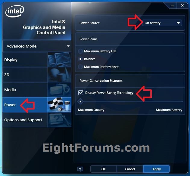

3. To Enable Adaptive Brightness
A) Check or turn on the Display Power Saving Technology box for both On battery and Plugged in, and click/tap on OK or Apply.​
4. To Disable Adaptive Brightness
A) Uncheck or turn off the Display Power Saving Technology box for both On battery and Plugged in, and click/tap on OK or Apply.​

Thank you so much, Brink! Option 4 is what I needed to stop this annoying "feature". I've searched all over and someone on the HP forums actually posted a link to this thread. My Intel control panel looks different, but all I needed to know was to TURN OFF Display Power Saving TechnologyDisplay Power Saving Technology. I am so grateful for your post. So much so, that I registered just to make this post. I think I'll look around while I'm here! Thanks again!
Thanks. Those pictures helped me get rid of the auto contrast feature. Very helpful

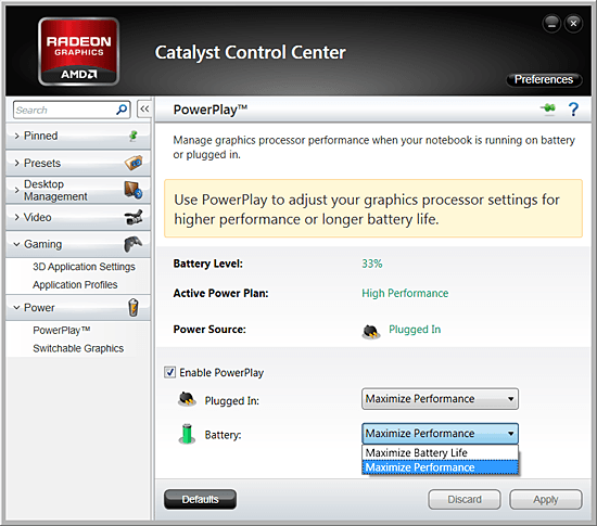

OK!! Stop looking I think I have figured it out!!! Yay for me, although I hope I'm not celebrating too soon.
In the 'Power Options' box the very last option is 'ATI Graphics Power Settings'
Which when clicked shows: ' ATI Powerplay Settings'
Defult setting is: 'On Battery' set on 'Maximize Performance' and Plugged in set on 'Maximize Battery life'
I changed 'Plugged in' to 'Maximize Performance' AND Tadaaaa!! All fixed.
Thanks for your help though, without your tutorials I would never have looked at the other settings in the 'Power Options' box.
Kind regards
Hilary
Edit: I think I have the original settings backwards but the result is have both settings as 'Maximize Performance' and it's all working fine.
    Toshiba L750
Perfect Hilary. :party:
Does unchecking the "Enable PowerPlay" box stop it for you as well?
Hi Shawn,
I can't find a Catalyst Control Center from my Search bar.
I do have a similar looking AMD VISION Enging Control Center but it doesn't have the options your image shows
On the left-hand menu there are only three choices: Pinned, Presets and Power.
There is an option to Enable or Disable Smart Sleep and I tried both settings but neither choice had any effect on the dimming problem.
Perhaps it is because I don't have any gaming software or didn't allow gaming features at set-up?
Hilary
    Toshiba L750
Usually you would see the CCC option when you right click on the desktop if installed.
No worries though. The main thing is that you got it to work using the max settings. I was just wondering if it would have the same effect if you disabled PowerPlay. :)

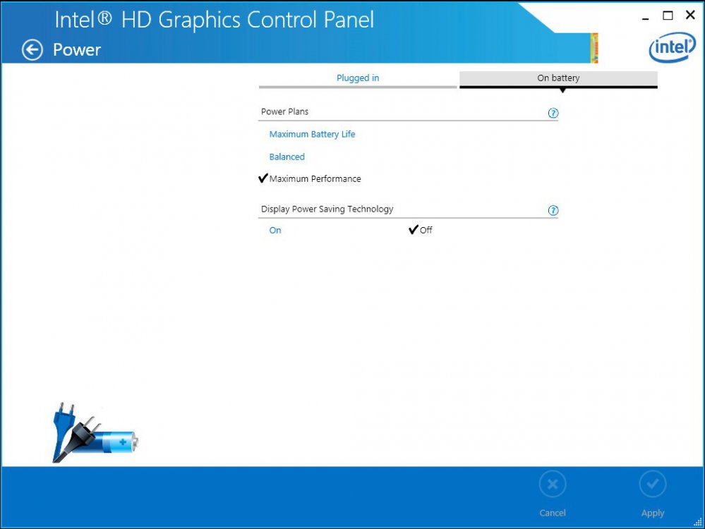

Hi I've got an Acer Aspire and I've done everything you said to disable adaptive brightness and when I take my charger out, the menu in intel for 'power saving technology' keeps turning back on, and then my screen goes dim. I've saved it over 10 times, disabled it everywhere but it keeps coming on in that menu. Any suggestions? Thanks :)
Hello 3476, and welcome to Eight Forums. :)
Did you set this for both the "Plugged in" and "On battery" settings?
I have and then as soon as I put my laptop on charge and take the plug out, it reverts back to the setting where it's turned on. It also does it when I shutdown, thanks!
Nevermind, it seems to have came back on. I've disabled every adaptive brightness setting and done what you said, do you have any other suggestions? Thanks:)
