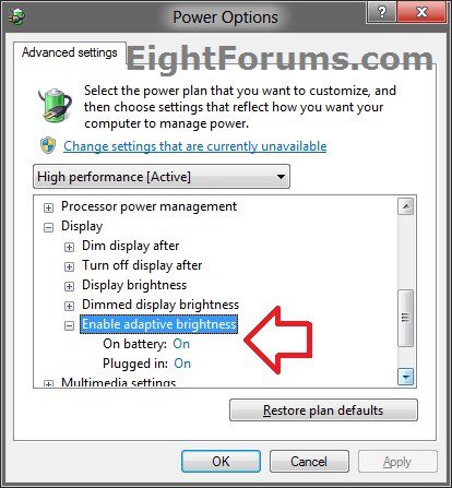

1. Open the Advanced Power Settings for your power plan.​
2. Expand Display and Enable display brightness, then set adaptive brightness to be turned on or off for when your computer is On battery and Plugged in. (see screenshot below)​
3. When finished, click/tap on OK, and close the Power Options window. (see screenshot above)​

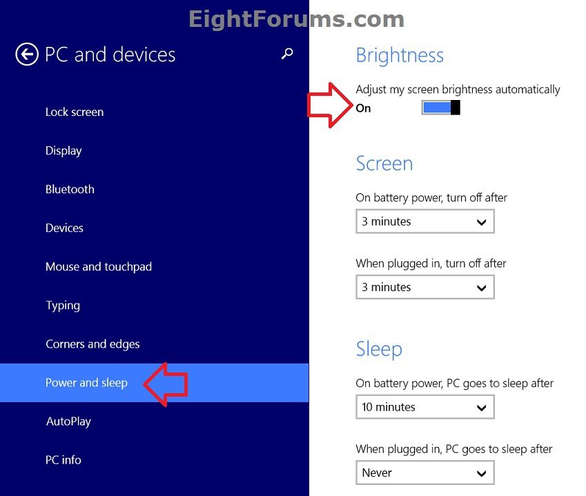

To Turn Adaptive Brightness On or Off in PC Settings in Windows 8.1
This option will turn on or off both the On battery and Plugged in settings for your power plan in OPTION ONE above.

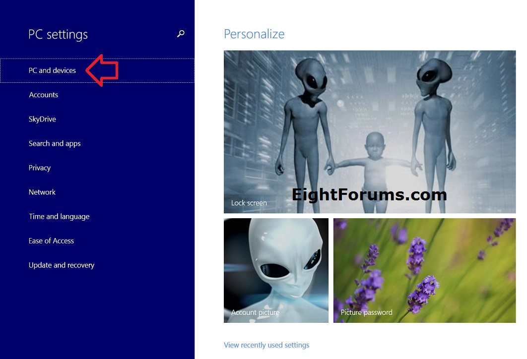

1. Open PC settings, and click/tap on PC and devices on the left side. (see screenshot below)​
2. Click/tap on Power and sleep on the left side, and turn on or off Adjust my screen brightness automatically on the right side under Brightness. (see screenshot below)​

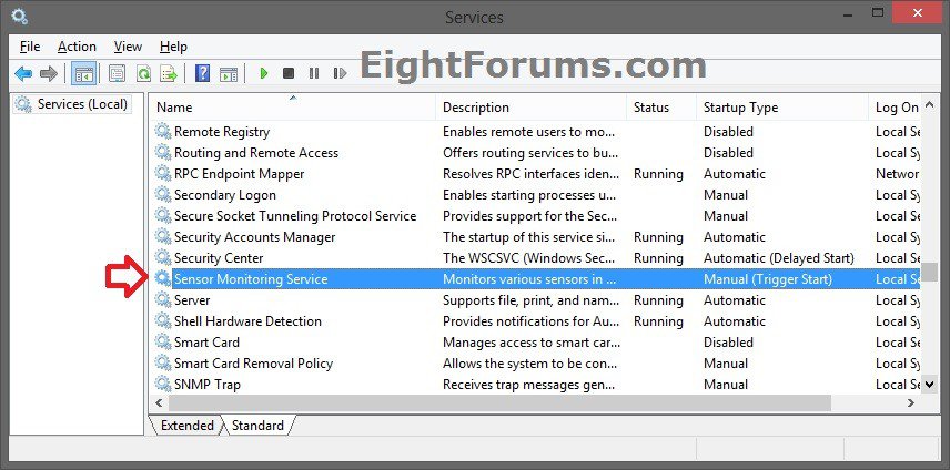

To Enable or Disable Adaptive Brightness in Services
NOTE: This option should really on be used if OPTION ONE or OPTION TWO above did not work for you.
1. Press the Windows + R keys to open the Run dialog, type services.msc, and press Enter.​
2. Do step 3 or 4 below for what you would like to do.​
3. To Enable Adaptive Brightness
A) Enable the Sensor Monitoring Service, and set it as Manual (Trigger Start).​
4. To Disable Adaptive Brightness
A) Stop (if running) and disable the Sensor Monitoring Service.​
5. You can now close Services if you like.​

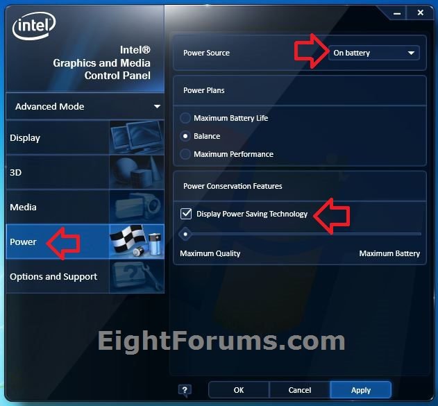

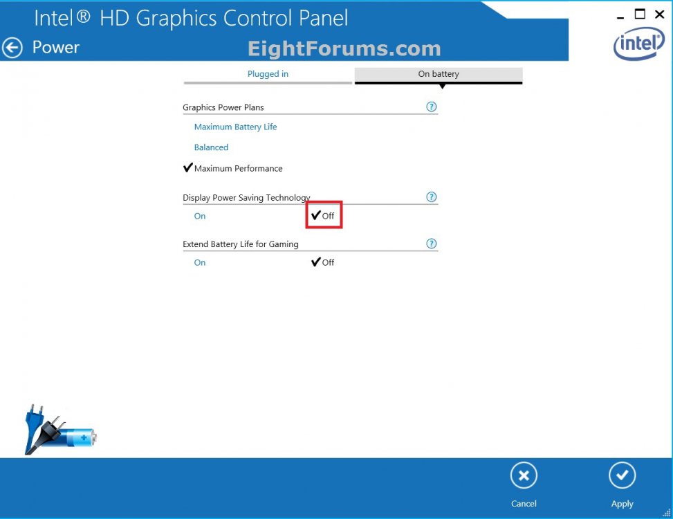

Enable or Disable Adaptive Brightness in Intel Graphics Control Panel
NOTE: This option is only if you are using Intel HD graphics on your PC. You may need to do it in addition to the options above. If you are using NVIDIA or AMD graphics instead, then this does not apply to you.
2. Click/tap the Power icon, and do step 3 or 4 below for what you would like to do.​
A) Check or turn on the Display Power Saving Technology box for both On battery and Plugged in, and click/tap on OK or Apply.​
A) Uncheck or turn off the Display Power Saving Technology box for both On battery and Plugged in, and click/tap on OK or Apply.​

Well for some reason this didn't do the trick for (and I've been stuck with this, very frustrating feature for about a month now)
What did work however, was disabling the Sensor Monitoring Service.
Sorry to hear that Talmarsh. I added that option to the tutorial for those that have the same issue.
Thank you for posting back with your results. :)
