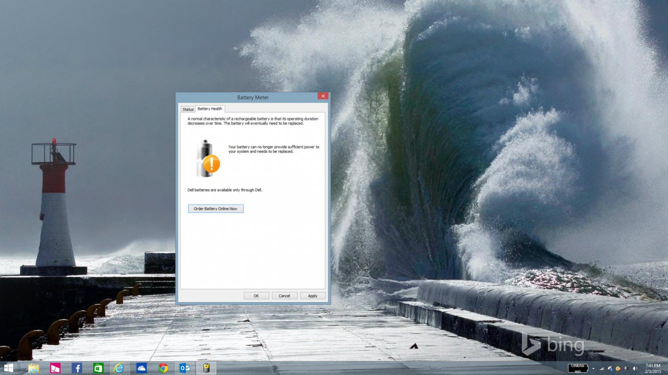

I installed quickset. On install I got an error message stating the battery needs to be changed... However, I've been on battery life for the last four hours... So I know the battery is working fine... If I try to open "Dell Extended Battery Life Options" in power management, it crashes with "Battery Meter has stopped working"
Screenshot attached :(
