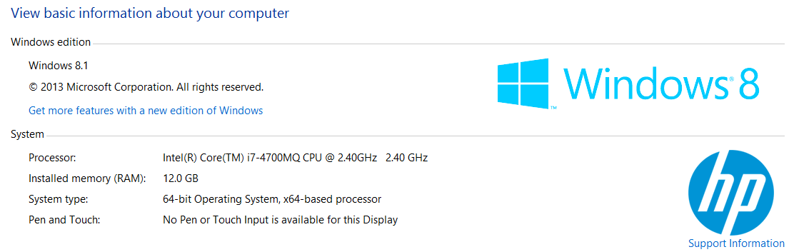

My computer specs:

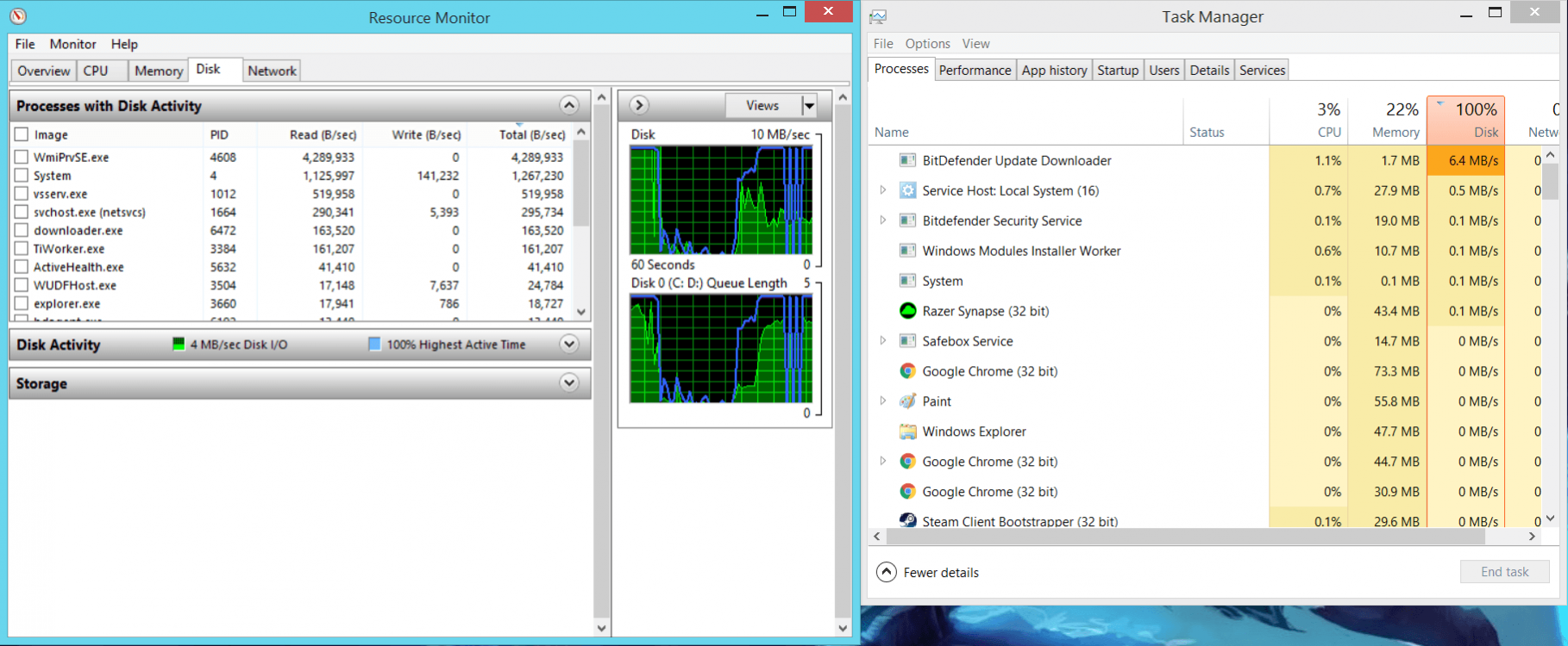

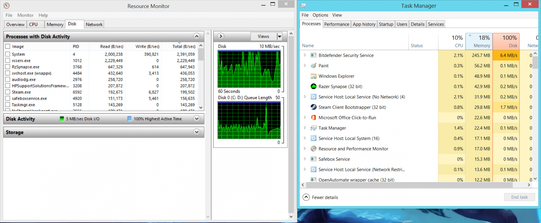

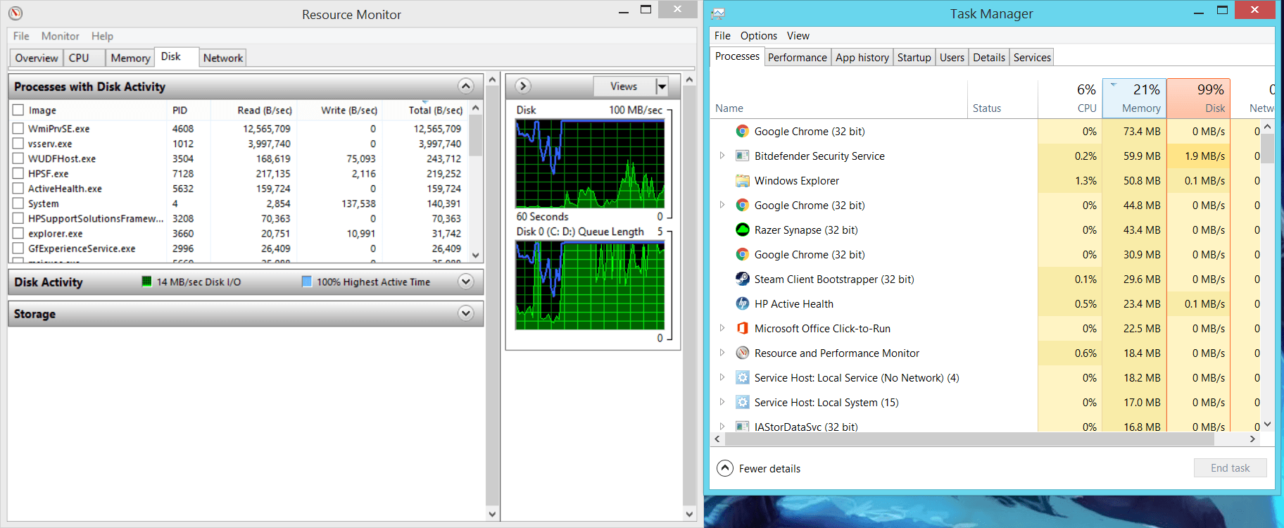

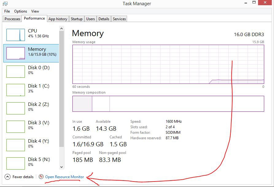

I looked at the resource monitor on my startup
Here are some screenshot that I took:

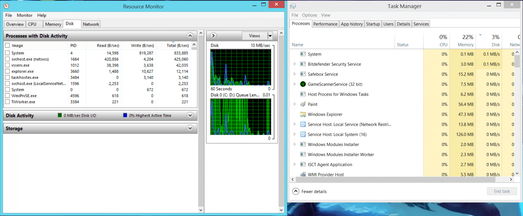

Those happened in the first 10 mins of the startup.

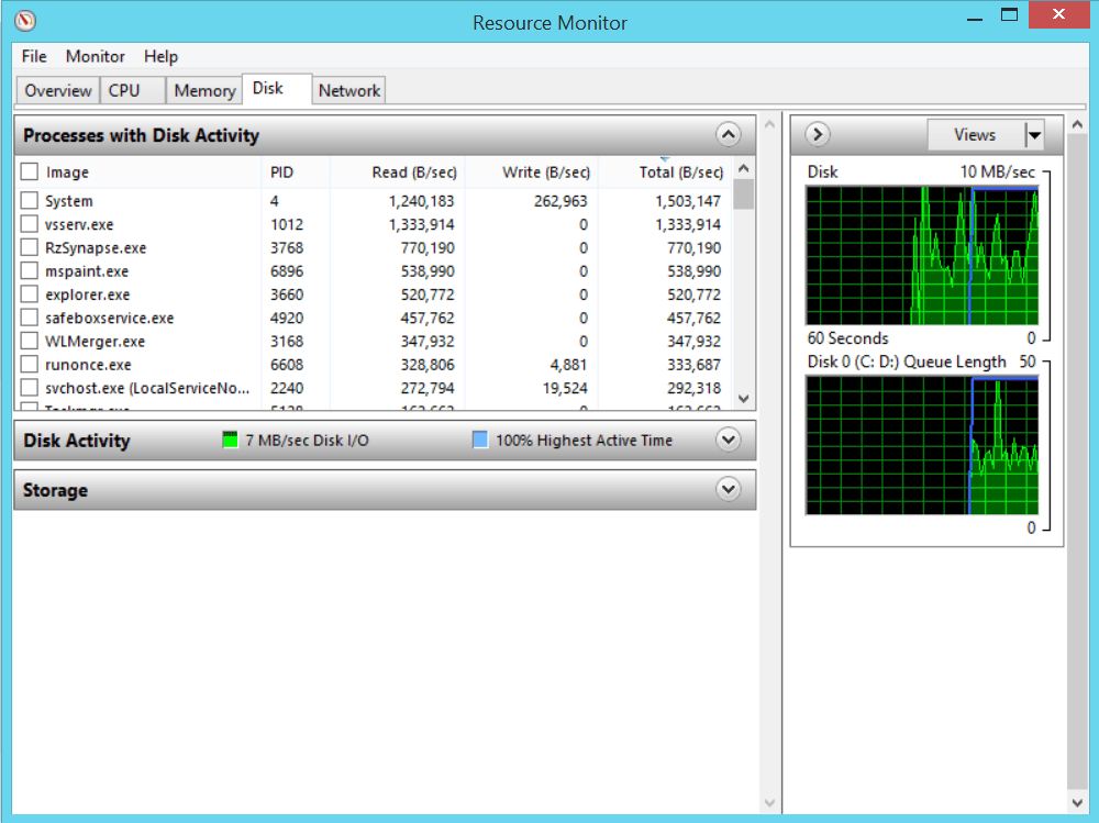

I noticed that there were some process that takes a lot of disk usage.
And right now when I look at my resource monitor there are only 6 process that is using the disk:
system
svchost
chrome
explorer
audiodg
dwm
Sometimes there are only 3 to 4.
I have ran the ESET scanner, it found 6 threats and deleted them.
I think that the bitdefender was a big issue. After I disabled it, my computer will run smoothly after 5mins instead of 10mins

I found what the game scanner was, it was my razer synapse.
Anyway, I think my computer is running better now.
