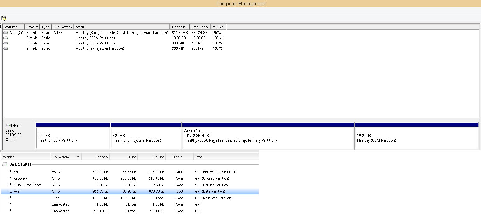

Yes, there are two OEM partitions. One one of 400MB listed in EaseUS as Recovery and the other one 19GB, listed as Push Button Reset.
Just attached the disk manager and
EaseUS screen.
My screenshot:
    Win7/8

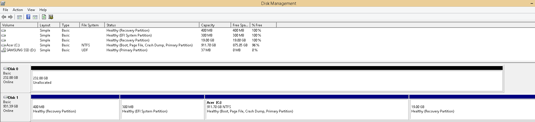

Omg thanks so much genet :D I just found the wrong thread of the problemhaha...
Just wondering, what should I pay attention to when using EaseUS in the future? (or avoid using it...?)
Why did we change both partitions from OEM to Recovery. I get it for the first one because it actually is the Recovery partition, but why the partition with the operating system on it?
    Win7/8
You are welcome.
400 MB Recovery partition - This partition contains Windows Recovery Environment tools and utilities, allowing the user to repair problems that affect the system drive.
19.00 GB Recovery partition - This partition contains the recovery image that would be restored to the system drive if the Refresh or Reset option in Windows 8 is used.
Recommended UEFI-Based Disk-Partition Configurations
To configure Windows RE tools and recovery image partitions, identify the partitions as utility partitions by setting the partition type:
- In the DiskPart tool, after you have created and formatted the partition, use the command set id=de94bba4-06d1-4d40-a16a-bfd50179d6ac
Here is info about reagentc /info -> link

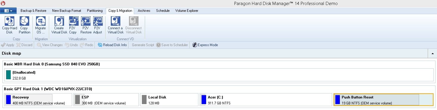

So I read a few posts that Paragon is safe to use.
Paragon 12 has full support Windows 8 uEFI, GPT & Secure Boot.
However the first thing I saw when opening "Paragon Hard Disk Manager 14" is that Recovery, ESP and Push Button Reset are all shown as "OEM service volume".
Compared to my disk management:
Can I assume it is not safe to use?
